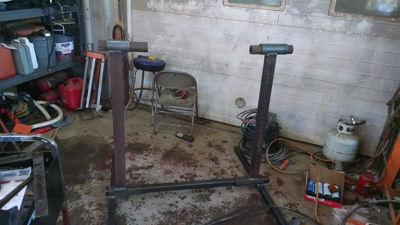

it's been a while, but i'm finally getting around to building my engine, i've got two cores to build from, pretty much which ever one has the better bore. but im building this to work on it.
IMG_20150227_164338297 by my04cclbstroker, on Flickr

I'm building a motor stand like that. Looks good. I'm trying to figure out how to use a timing gear set and chain to turn it, so you don't have to man handle it, just haven't gotten that far yet.

I've thought about it as well, the closest thing I have come up with but have been to lazy to source would be a boat lift gear thingy. I think that would be about perfect. Then make it impact gun driven for the ultimate in laziness.

That's really the only thing I could think of, and we have a few from SBC, so they are plentiful. Just need the correct size bearing and some time to mount and finish it.
If you come up with something be sure to post it, I might steal your idea! Lol.
