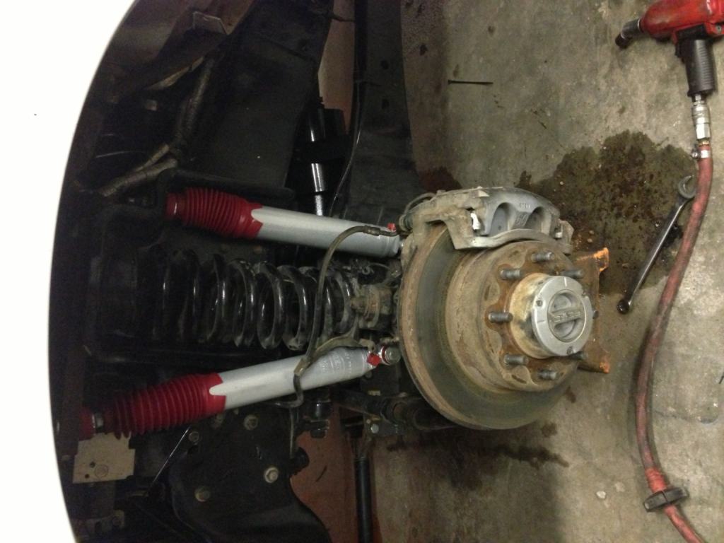

Yeah I know the lockouts are junk. Don't have any flanges yet.
Dual rancho 9000's up front.
