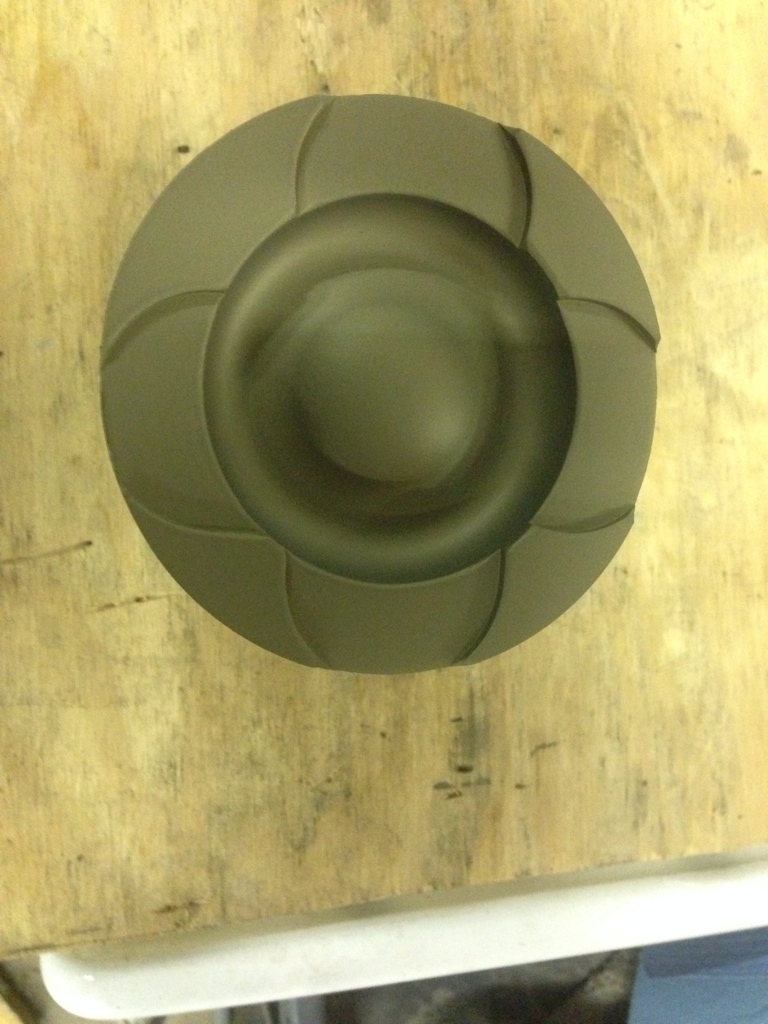

holy chit at that piston!

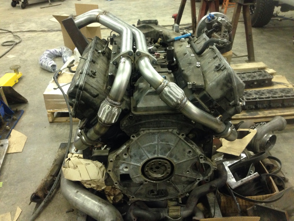

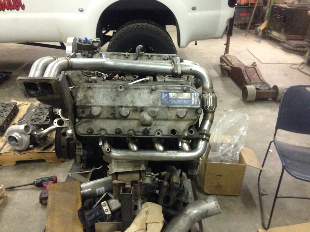

Here is how the new setup is going to run. Big thanks to Jared for hooking me up with those sweet RCD tube manifolds and HD up-pipes! These are beyond gorgeous! Plus they made less work for me to build on the new setup. The turbo is moved out front to allow the mammoth hx82 fit without cutting a hole in the hood. It will also make it easy to swap turbos back and forth for different classes.
So far I am way happier with this setup than the old one.
Got it all in and was able to fire it up! It has the 2.6 charger on it in the video. But I am hoping to pull next weekend so I have a lot of work to do still!

I'm surprised you didn't flip the manifolds around, and shorten the plumbing. Good luck with the new setup. The progress looks great though.
Oct 1, 2012
5,868
Athens, IL
I really wanted to. But that would have required me to move the dual pumps and alternator. And that was not gonna happen! Thanks though. I wish I could have done it without all the runner length. But I spool at 5500 rpm so it should still be moving plenty of air to light that turbo. Never had a problem before so it should be fine. And it's super easy to work on now with a completely open valley.
