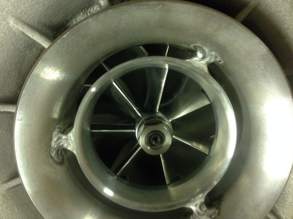

It's a 3.0 charger for the 3.0 class. But as it stands now I'm not sure when I am going to have it. And it's not going on the truck now because of time constraints. It is an hx82 based turbo clipped down to 3.0" inducer.

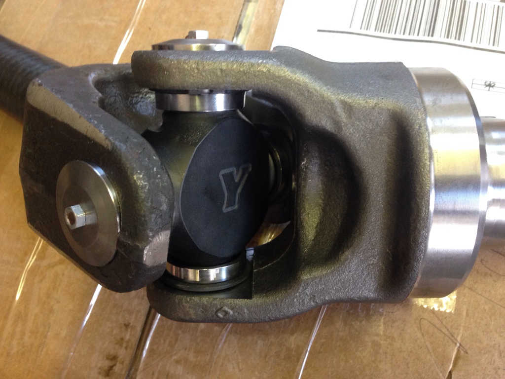

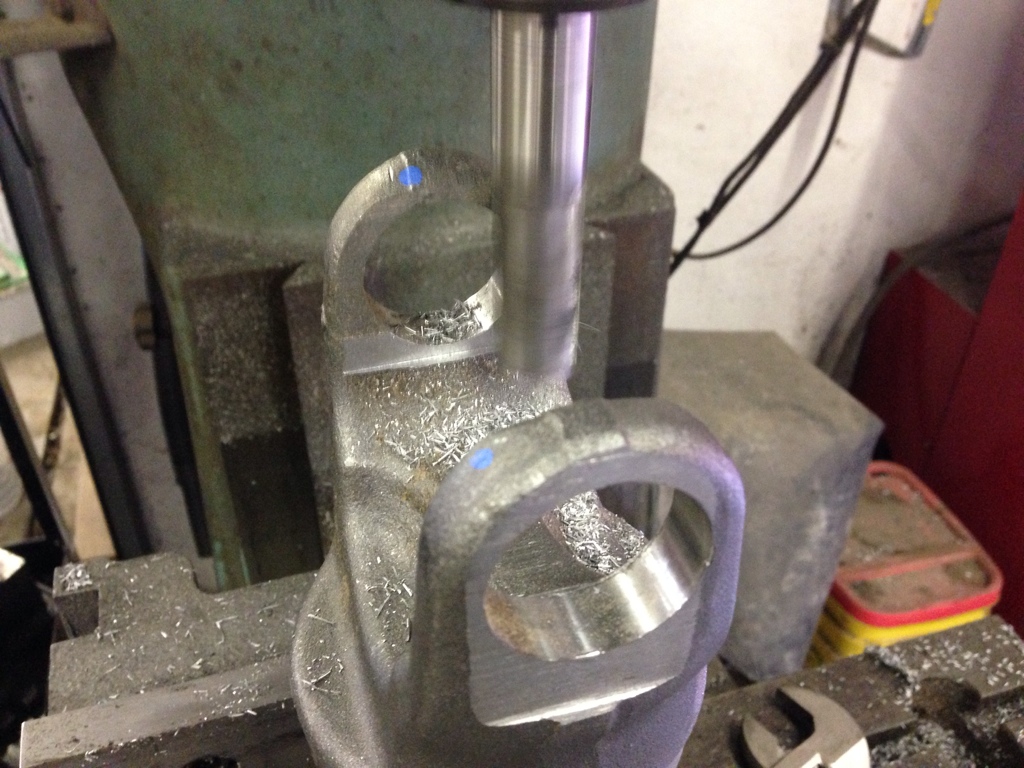

Little axle work...
Found this...
Made these

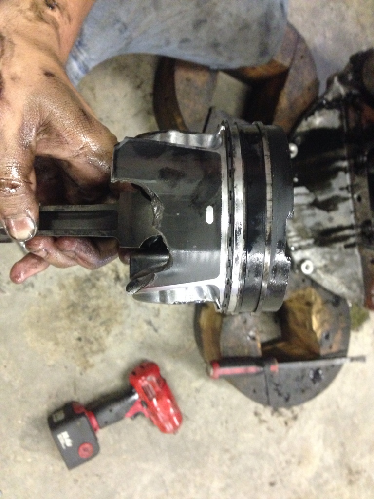

Had to go a little farther in than I wanted. That is why the new engine I build this winter will have forged pistons. Cast just can't handle it. On the bright side the bearings looked like they were brand new. But the lifters were shot. So another new set of lifters will go in. Rockers looked swell. Pistons on the top side looked fine as far as heat goes. But they will not be going back in for obvious reasons.
