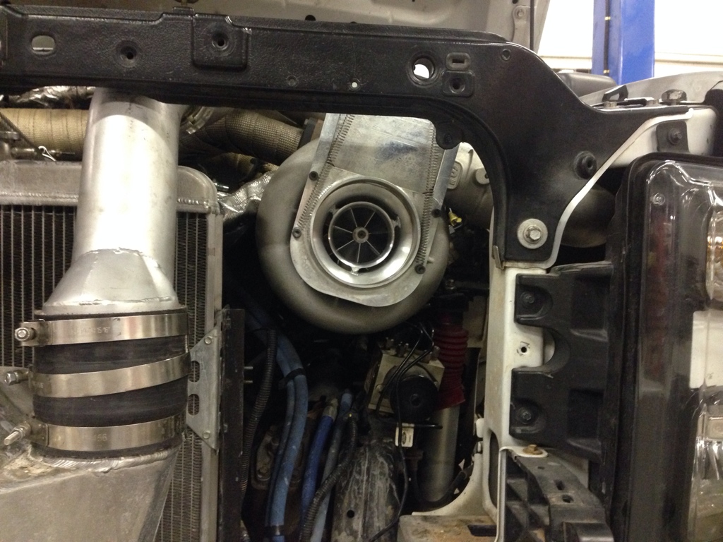

Well since I have some down time before scheids, the hx60 got sent off for some freshening up and upgrades. So I put the hx82 on and finished the piping.
Also put a new slave and master cylinder in since the old one didn't like the new triple disk. Couldn't hold it on the line just started walking out at 4500. This one feels better.
