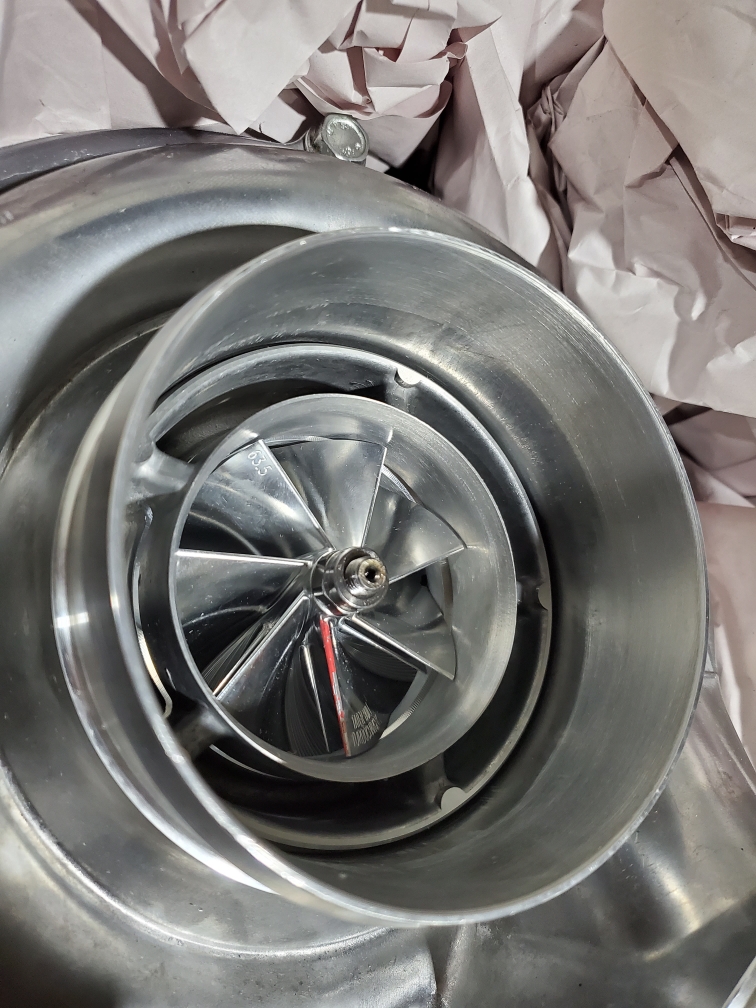

Here is the Drop In VGT that Tater Built did for me. Got it back yesterday.

That things going to light quick, have you installed your 10mm stroker pump yet?

Negative. Pump and turbo are both sitting, I bought a couple turbo pedestal gaskets and other FoMoCo OEM seals/o-rings I need to swap the turbo and pump on so that I'm resealing everything with brand new OEM stuff.
I'll be swapping both parts on in abut 2 weekends after King of the Streets has passed, I'll have a better update then.
I'm adding some OUO 3-Link ALA's on as well and a Hellwig rear sway bar, just waiting on my ALA's to show up from OUO. Those will be the last items for this truck and then I'm done with this thing for quite awhile.
