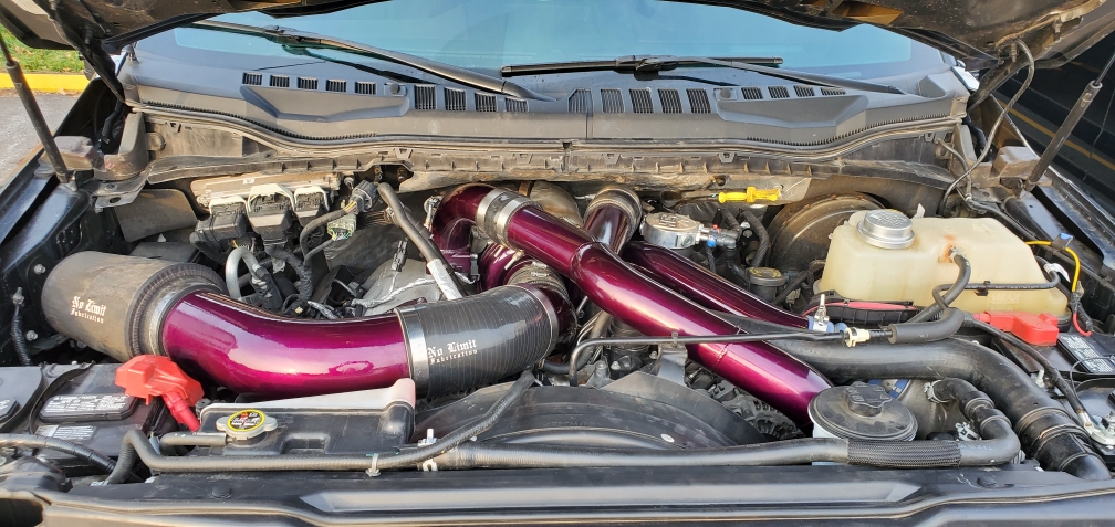

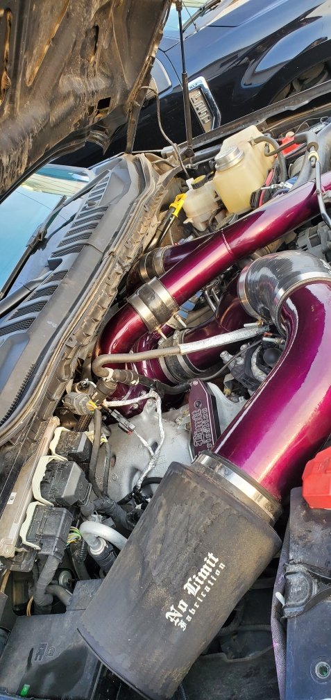

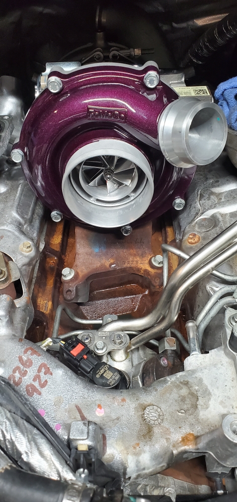

Got the Tater Built Drop-In Turbo and Exergy 10mm Pump swap done this past Saturday. Went very well, zero issues. Had it all done in about 5 hours, big thanks to my buddy Travis for helping me out on this.
New turbo and pump definitely make a very big difference. The stock turbo is largely restricted on airflow compared to the modified drop ins and the new exergy pump flows quite a bit more fuel, it fuels very very hard.
It is currently on a 2200us tune, I will probably run a lower fueling tune for every day driving so that it doesn't smoke so much in the lower RPMs before the turbo lights.
Other than the fueling, it runs very very well and the driveability is 10x better than before. I 100% fully believe it spools faster than stock. The turbine whistle is also quite incredible now. The whole truck sounds completely different.
My 3-4 shift flare was quite pissy at first at the added power but it is all already learning and is doing much better already.
I still think a mildy built trans is in my future for next year most likely. It would definitely help with this setup.
