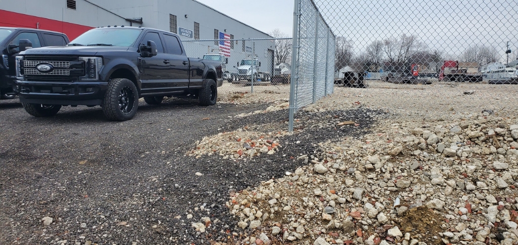

Truck is at 65,000 miles now. 2.5 years of owning it. Have been dleeted almost 30,000 miles and I've had the workstock VGT turbo and 10mm on the truck for almost 10,000 miles now. 8k on the built trans. Still running like a top. No power train or mechanical issues at all since my trans got rebuilt.
Only issue is Im suspect that my steering is starting to give out again. It went out at 30k mileage originally and I had to replace my tie rod and drag link assemblies and ends.
If it does go out again soon, I'm buying everything PMF and junking the OEM FoMoCo parts.

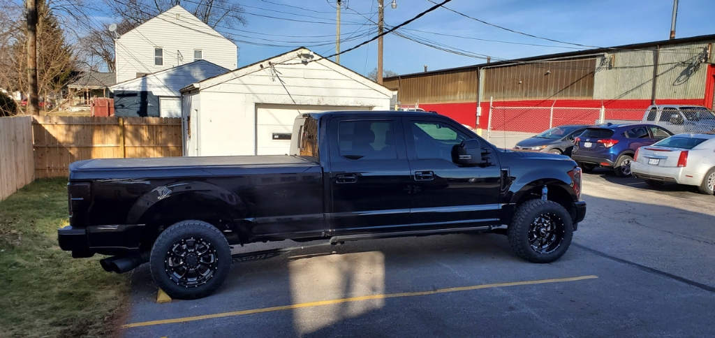

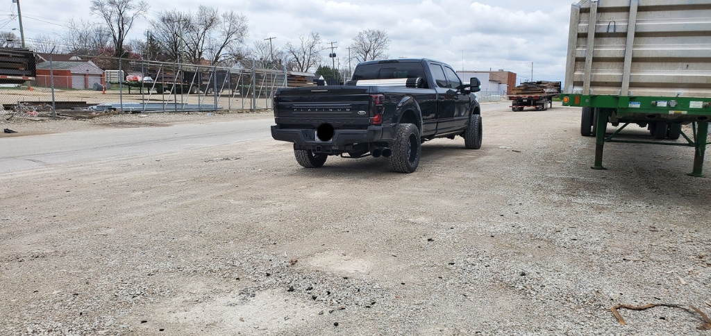

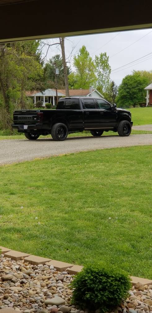

Update.
Truck got a new Valve Body from WDI which cured my 2-3 shift issue. Did a FASS 140gph LP system as well. New PMF steering linkage since my OEM steering went out again for the 2nd time inside 65k mileage. Did the PMF track bar, tie rod and drag link and all new heim joint ends. Installed some PMF rear drop shackles as well to drop the rear end 3/4" to help level the rear to the front better.
Truck runs and drives amazing. Steering is on point and now I can enjoy the truck and leave it alone.
