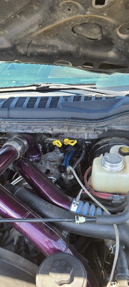

Truck surpassed 70k mileage. Nothing too new really. Still running like a top. FASS LP setup was having starvation issues at 1/4 tank so we drilled a hole in the tank and did a Beans Diesel Sump to fix that issue. While we were in the low pressure fuel system, we dleetedd the upper fuel bowl in the engine bay with the FASS dleet kit since it cant filter any lower micron wise than the FASS LP does. Cleans up the engine bay a lot and takes the injector return line port and routes it back to the FASS so that fuel gets filtered by the FASS pump.
Yes I know, Truck is filthy in the pictures, So is the engine bay.

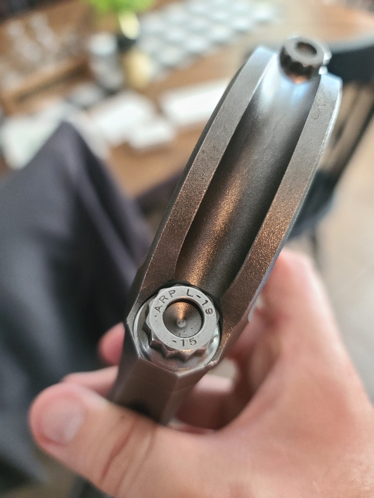

....I did maybe buy a set of Rods because why not. Very first set of production run D&J Precision 6.7 PSD X-Beam Connecting rods with 35mm wrist pins for 17-19 engines.
