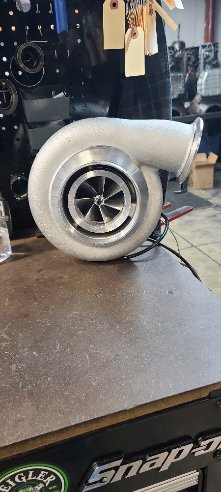

Getting closer. Exergy 45% Injectors get ordered next Monday
Had to switch my S480 compressor cover. The one I had was wrong. All good now!

Got some coatings done on the new parts this past weekend. Big thanks to Lyn at Firepunk Diesel for the assist on this.
Intercooler and s400 Compressor cover are Prismatic Illusion Malbec and the piping is Prismatic Illusion Copper.
S400 exhaust housing got hi temp cerakoted
