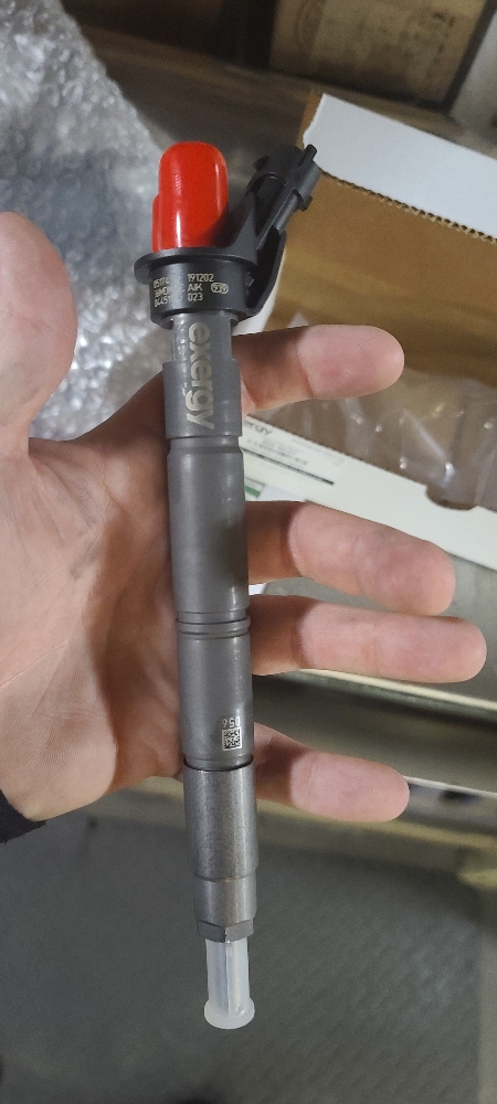

New Exergy injectors have arrived

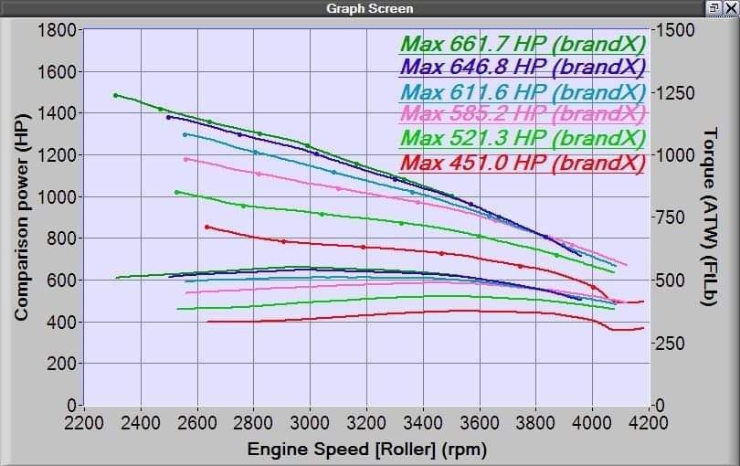

Finally got back on the dyno at Firepunk. Today went very well. 200HP spread across 5 tunes. Tune 1 at 451 whp, Tune 3 at 585whp (this is my daily tune) and Tune 5 at 661whp. Max torque was about 1245 tq on tune 5.
The Warren Built 6R is an absolute unit. It holds the power now and doesn't even care.
The setup currently as a reminder is very simple. It's a 64/67 drop in Mod VGT, an exergy 10mm cp4, a Warren Diesel Comp. Unit 6R140 Trans and a FASS 140GPH lift pump.
I was very happy to see the setup Crack 650whp. These 63mm or 64mm VGTs all say they are rated for about 650whp max with proper fueling and this setup did exactly that, about 1.5% more actually. Close enough!
FI S480 and Exergy 45% Injectors happen next week. Dyno again in Jan 2021 once I'm back from vacation.

Fantastic!! Do you have stock numbers to compare to?
Earlier in the thread I posted results when it was stock fuel/air just tuned with weight loss and an intake/exhaust. Max effort back then it did 550/1100.
So the setup now is a 110HP gain and a 150 torque gain.
I am guessing to see the torque number rise quite a bit when the S480 comes into play. I will have to be careful with that because the motor is stock.

Hows it light under 2k rpms? Be curious to see the graphs when the runs started at 1800-1900 rpms.
Nice numbers btw!
Black AOD
Aug 6, 2014
3,466
76
Ohio
Nice numbers btw!
It spools great no matter what RPM it's at. It spools faster than stock I think. We just started the runs later in the curve so not all the torque comes on all at once down low since it's a stock motor.
