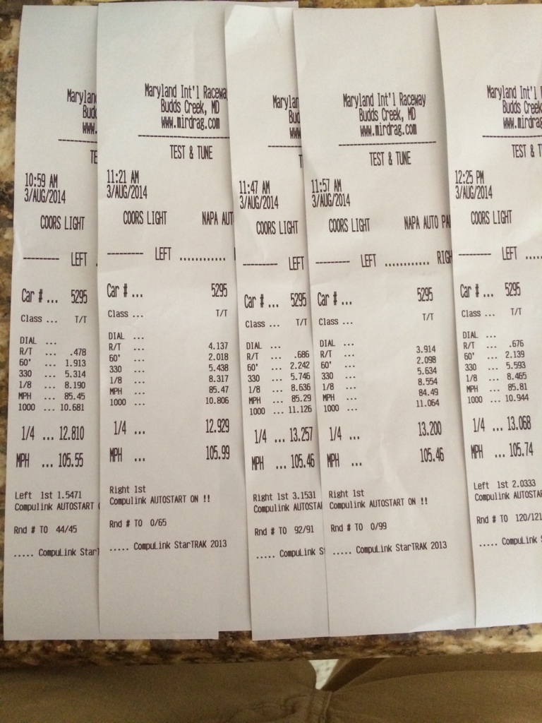

Best was a 12.81
72 degrees, high humidity, sea level
72/59 turbos
30% injectors (needs to be turned down more)
Cal trac traction bars
Front and rear 30psi. 35x12.50 nitto trails
I don't know what happened to the times. When I was done for the day I noticed the traction bars were very loose. I hope that's why I started going slower.

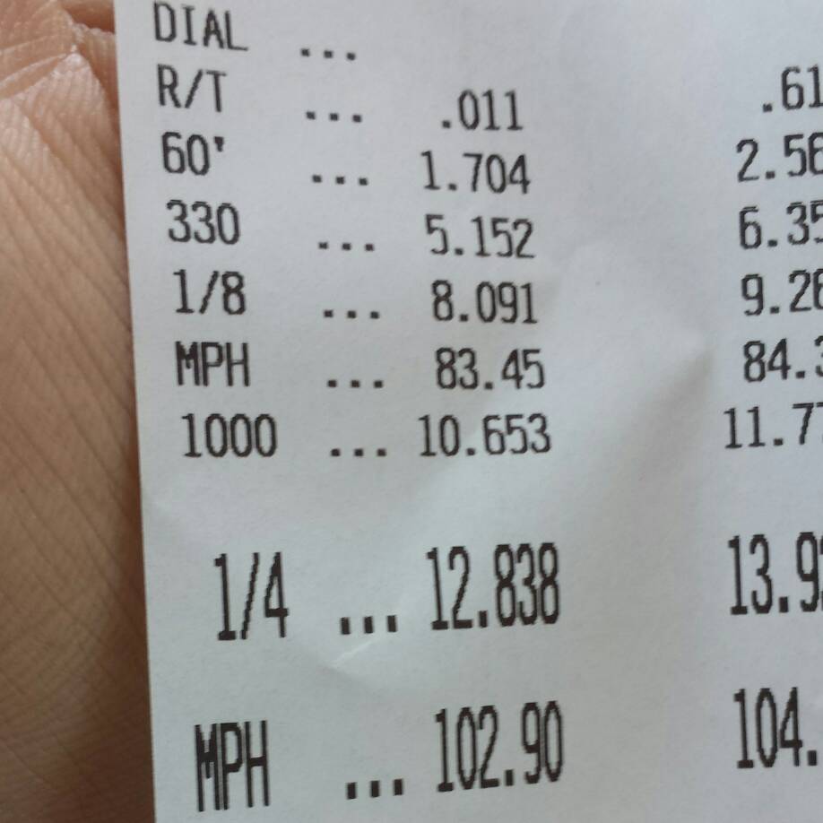

Good job for your first time man! Your mph is really consistent so the truck wasn't slowing down, you just really gotta figure out what's up with your 60'... I wish I was there to see what the truck was doing when you leave the line. You're at MIR so it's definitely not the track haha. Here is my slip so you can compare:
For everyone else in this thread, this is with Gearhead MCC tunes, No Limit intake, 4" delete pipe, and 6" stacks with some weight reduction. 7700ish pounds
Edit: don't know how the hell that picture of money got up there but I can't get it off...
I had the same 60' as you and same mph but couldn't run faster then 13.05. wasn't spinning on the launch either just leaving hard. and my truck was at 7980

3.55 you think my truck could be losing rail pressure up top?
Mine has 3.73, that's probably where the difference is coming from. I have a better 1/8 mile than you even with the same 60'. Rail pressure would show in mph which yours does seem a little low so that could play a part as well.

The only way to know that is add a fuel pressure gauge but I doubt you're dropping low pressure fuel unless you have a ton of miles. Have you noticed it dropping rail pressure on whatever you use for gauges? (Mini max ext ect)
That 102.9 is actually the slowest mine has trapped. I usually trap 103.5ish

i only have 103,000 miles. i actually don't running any gauges, I have borrowed a friends dash daq and made several pulls down the highway a few separate times when it was empty and didn't notice it dropping at all. it held 24500-24600, 25000
