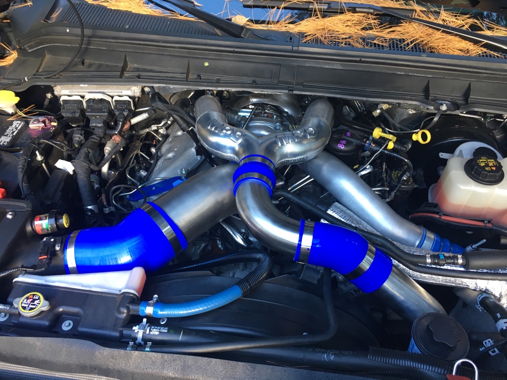

Finally got her back together over the weekend. The project proved to be more difficult than I anticipated but which ones go exactly as planned ! I made a Y pipe that came out ok but I was worried about the slag on the inside of the pipe I could not clean out. That's what I get for using flux core wire. Lesson learned. MPD hooked me up with their Y pipe and I fabricated the cold side and air cleaner piping. Still working on a solid tune for the new streetmax but so far the thing is a beast. I'll be headed to the track , 1/4 mile , next week and I'll post some slips.

What size is that intake piping? looks bigger than the MPD kit supplys.

I used 5" from the s&b to the turbo . The rest is 3". The only MPD part is the actual Y pipe. Not a kit.

I was lucky that MPD had an extra laying around. It's tough for them to separate one out of a kit but give them a call maybe they can help. Otherwise buy 4 - 2.5" stainless 90s and a Short 3" pipe. Bring your factory plastic manifold to someone that can tig stainless and have them mock something up. That should be effective and pretty cheap.

To keep egr/ ccv intact with aftermarket piping kind of defeats the purpose of high flowing piping. You would have to incorporate a butterfly valve to blend exhaust gas to boost gas and a nipple for the ccv vent to connect. To to mention flanges for the exhaust gas connections.

What I meant before is that when you have to pass emissions again the intake piping will have to come off and ccv and factory plenums replaced. If your doing that , might as well remove and replace the cooler. It's only another 2 hours maybe.
