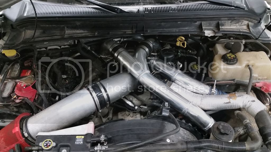

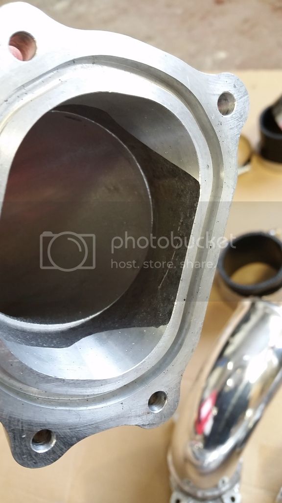

Finally got around to installing the intake piping. Full 5" right to the turbo. Did a No Limit CCV mod while in there. Thank you to everyone who helped with this, information or hard parts. You know who you are.
This pic shows the full 3" into the heads:

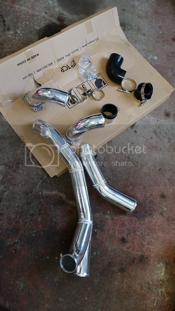

The parts required:
Final Product:
What do you guys do with that ugly ass coolant hose? Can I cut that heat shield **** off? I was thinking of covering it with some loom, the mesh stuff commonly used to rig boats.
