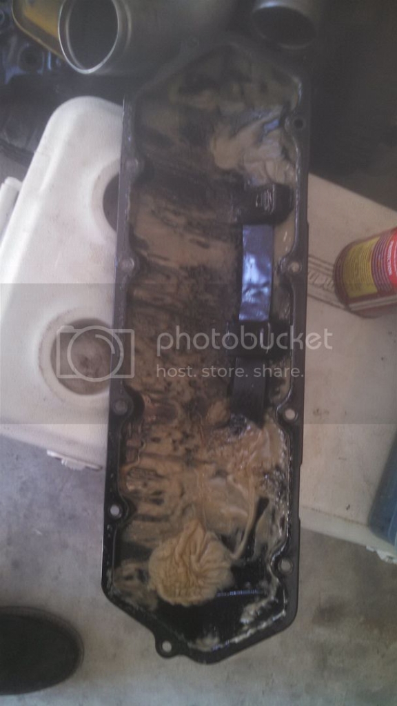

cake batter under the valve covers. Pulled the gp's and pressurized the cooling sys again. Withe oil drain open had water coming out. Then after about 30 seconds it started pouring out the #6 gp. attempted to bar engine over with gp's out and very hard to turn over. Didn't seem to change water coming out of gp hole and only hole coming from. With all the work I have been put through so far I don't even know if I want to pull and and replace the head gasket and not be the issue. I may just wait and find another engine.... again.

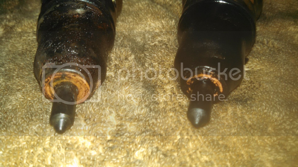

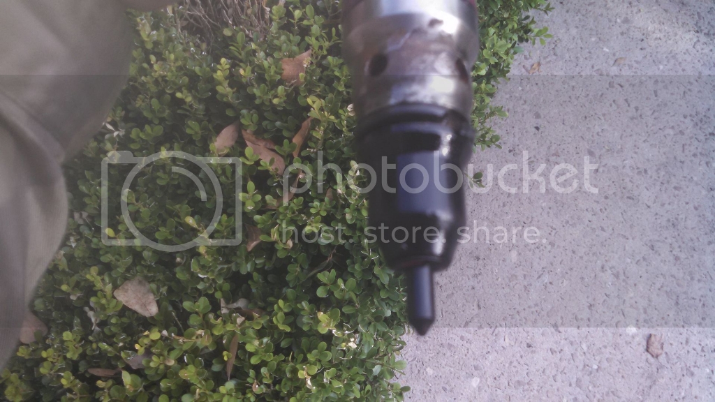

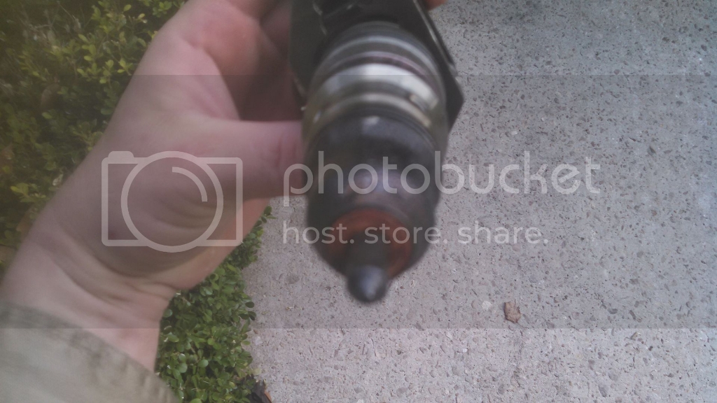

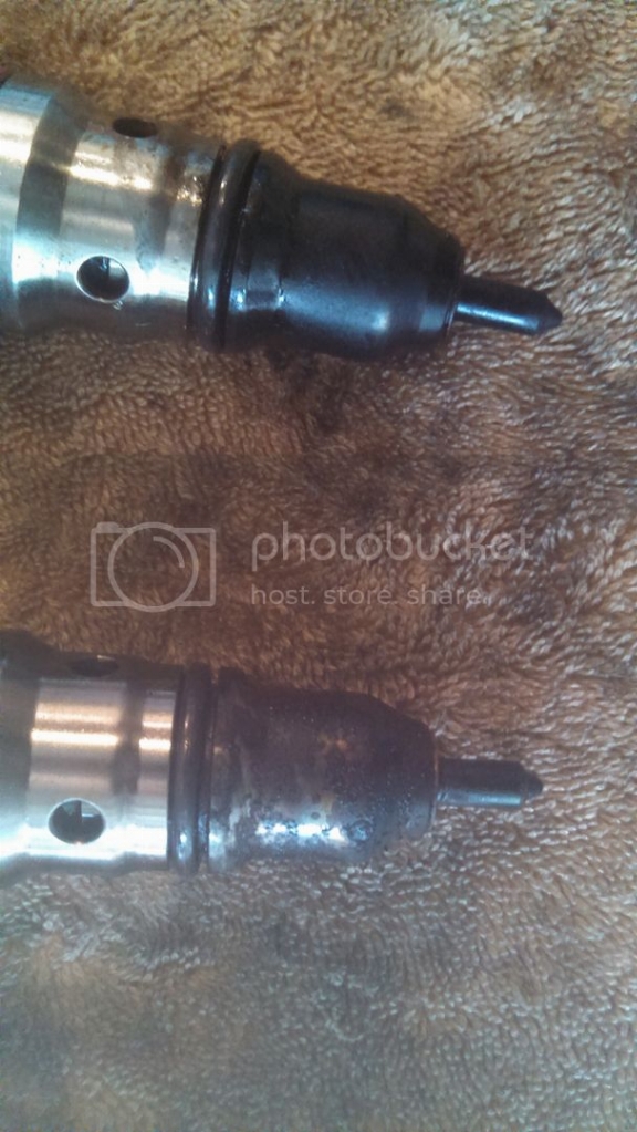

trying to see what the issue is before I remove it again. Just got done pulling injectors on driver side 2 and 8 look fine but 4 and 6 look like hell. Maybe my dumbass didn't install the new injector cups correctly. I used riff rafts tool and did it on engine stand but maybe I didn't seat them all the way..... Also I know I torqued all injectors down to spec and 4 and 6 were finger tight..... Don't know but if cups are the culprit I am hoping a set of new cups will be a fix maybe. But with all the gunk in the engine should I just back up and punt and tear it down and clean it all out best I can? Will post some picks of the two injectors. Will mess with pass side tomorrow.

ugh...
those blackened injectors were not seated properly.
you may not have a cracked block...just need someone to install the injectors and cups correctly, and reevaluate.
