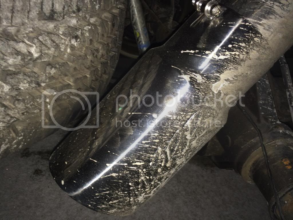

Finally had enough time to cut the exhaust again this weekend so it would clear the spare tire with the tip installed. I still might take a couple inches off the downward part of the pipe after the apex to raise the tip up a little higher...although I do like the fact that it clears the bottom of the spare so it won't get covered in as much soot...will get a better pic when its not dark out and filthy.

Thanks Bob - part of me still liked the way just the pipe looked better without the tip...I will see if it grows on me some more

Deffinately looks better with the tip on it, finished it off IMHO. I might try twisting the straight section of pipe an angle it out towards the passenger side a little but tho.. Just a thought

Hard to tell from the pics but I actually did angle a bit as compared to the first pics without the tip when I reinstalled the last section of pipe I had cut down. Maybe I will loosen it up and kick it out a little more.

Id say go with a larger tip and i bet your opinion changes, looks good though
