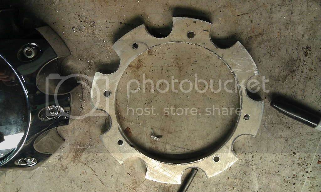

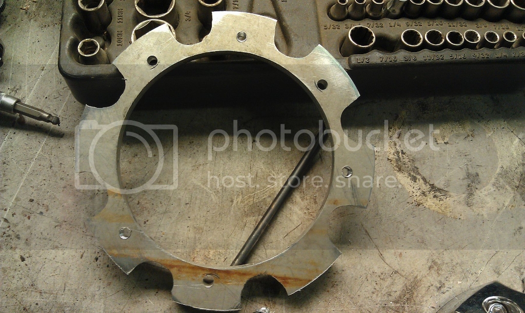

Nice use of a mill! Looks like a killer project!
Thanks i try to find every job to use it LOL
