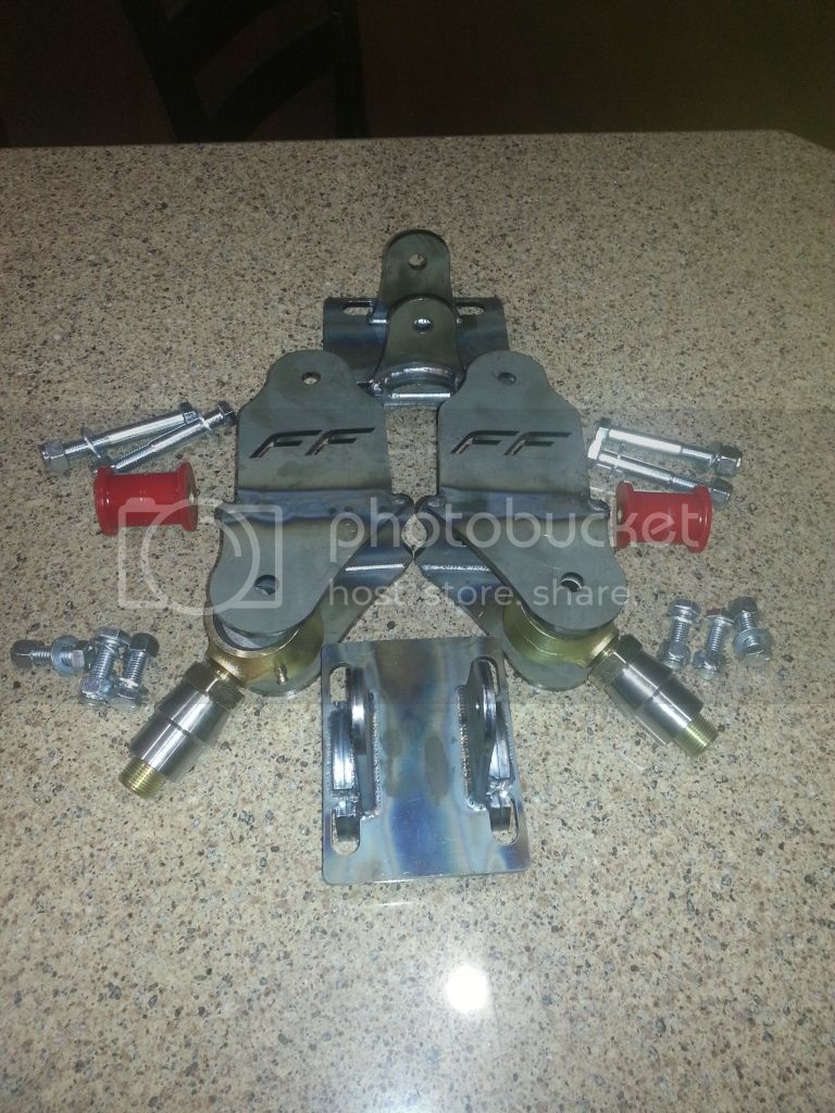

I installed a t500 to fix the check engine light I was getting in the hot tunes. I also got this in the mail last week too.

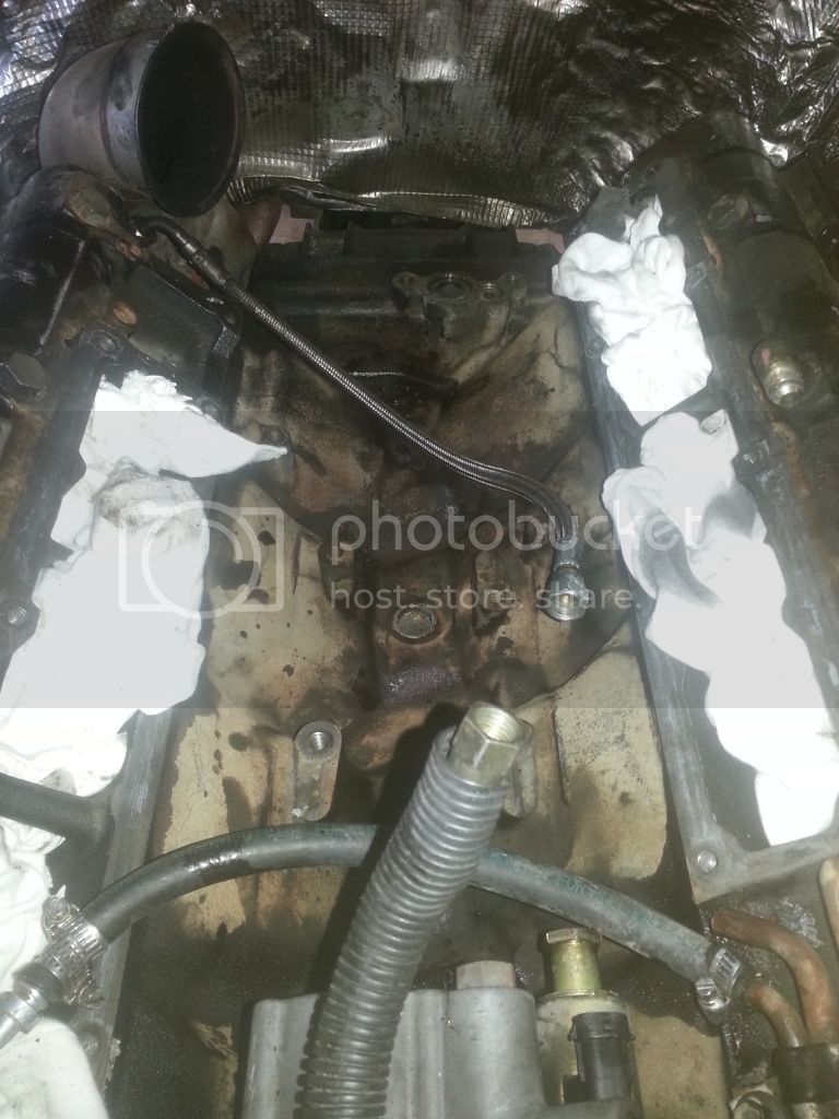

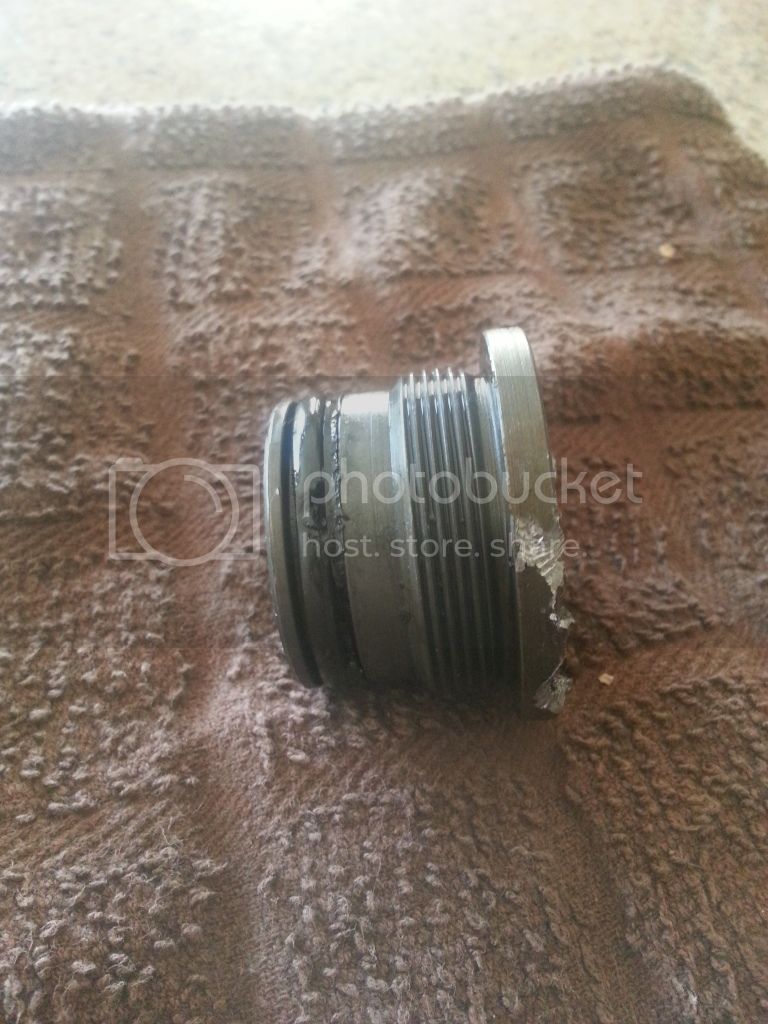

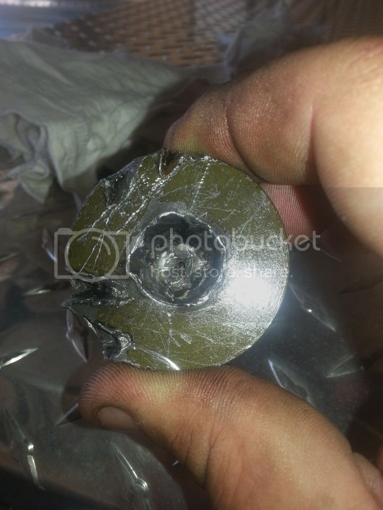

well, the whole top of the motor is tore apart. I'm fighting a oil leak on the rear of the drivers head and i cant get the oil galley plug out at all. So i decided to take the turbo out and the up pipes. Come to find out, they are leaking. Badly. So.... I guess its time for a t4 mount, a s366, and a set of 3'' plenums. I'm planning on changing the other oil galley plug as well while i'm back there and everything is out.
I'm ready to get it all back together so i can drive it.

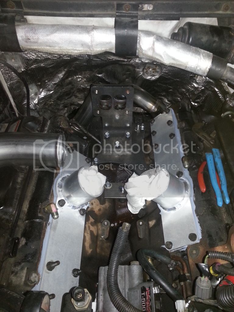

Got my Irate stuff in today. The quality and fitment so far is great. Everything went together easy as can be. I only needed a hand when i dropped the up pipes in.
I was worried that the intercooler pipes wouldnt fit since mine was already mounted and wasnt sure how jake had the pipe built. Its really looking like they may fit without having to cut them down. Which im shooting for.
