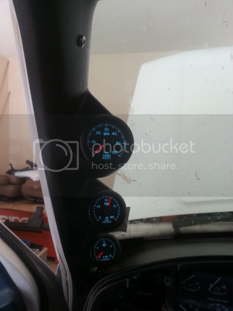

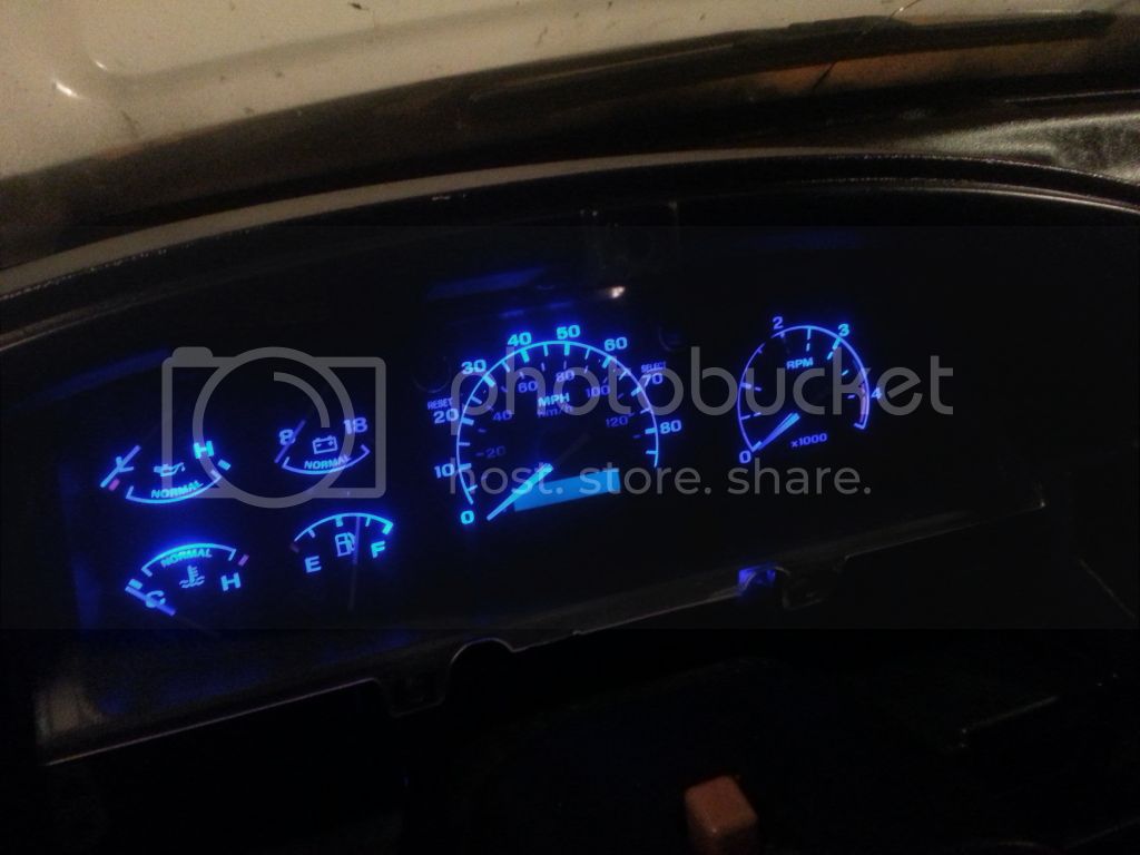

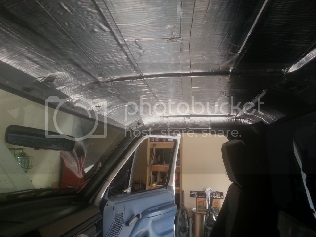

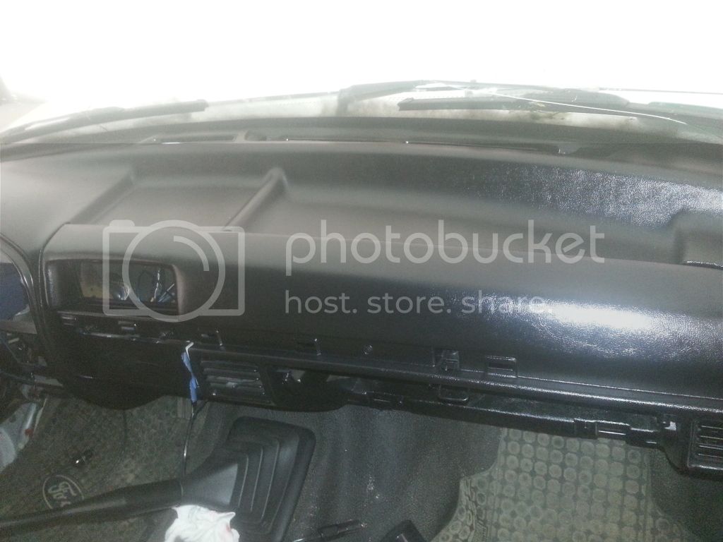

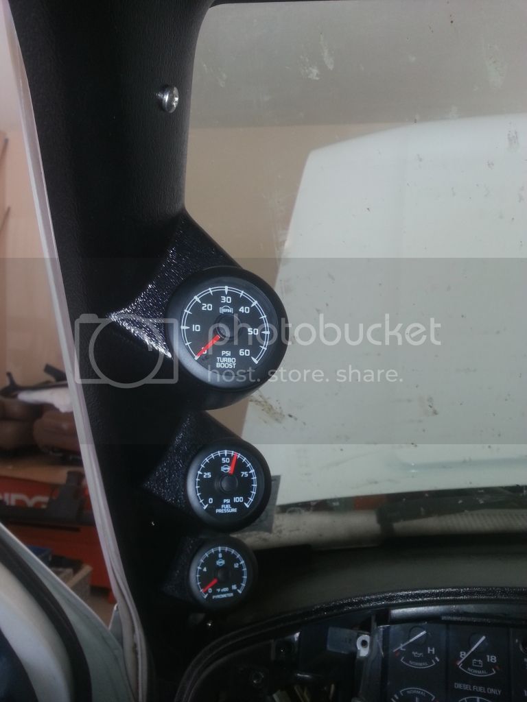

A few updated pics.
Sound deadner on roof.
Dash dyed black
Gauges installed
