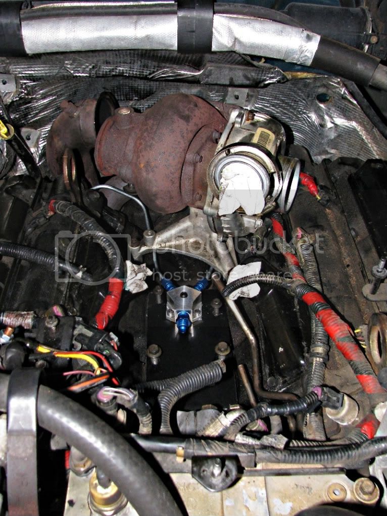

In the interest of getting this fuel system done in a timely fashion, I'm going to retain the stock hard lines feeding the rear of the heads and connect them to my y block with some braided hose and the appropriate fittings. I'll get new rubber washers for the vibra-lock fittings to be safe and whatever other fittings I need to connect everything together.

Its just really tight back there, especially on the driver's side. I know the stock 1/4" hard lines will be more than enough to keep my Hypermax Stage 1's happy, I'm just going to cut them off near the banjo fitting then run a short piece of braided hose from there to my Y block.

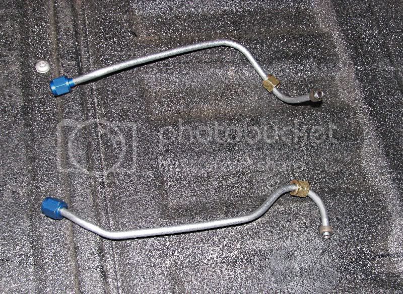

Between having to cut that fitting out, trying to get new lines to fit just right, and the limited space I think re-using the stockers is the best option and will get me going the fastest. Now I just need to order my filters and a big pile of fittings.

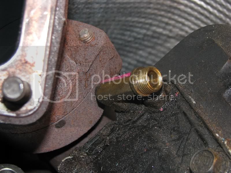

It unscrewed without hitting anything? 97 model?

Tom, here is the driver's side fitting on the 97 trucks. As you can see it is a one piece 90 and when attempting to unscrew the fitting it will hit the up-pipe connector.
