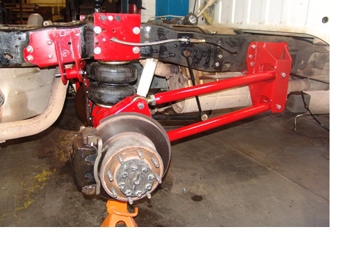

This looks pretty slick, not going to lie... I guess if it could be setup to handle a few inches of lift it would be one pretty trick setup. Correct me if I'm wrong but having this type of 4 link would remove the need for any traction bars correct? 4 Link handles all the rotational forces.
I did see you can get "bumpstop replacement" version too... So triple bellow bags with enough reach for a lifted truck would put all the load frame to axle... being as it's further inside, you'd get more articulation out of the same length bag too
I haven't even begin to look at clearances though.
That is a good reason for triple ^ but You gotta watch your height/compond heights its never good to over extend or compress a bag for long periods of time, typically causes the rubber to separate at the metal top plate...95% of the time the top plate, don't ask why. I just know from this Industry.
reyn7.3
Nov 4, 2011
43
Wow, That kit looks really good and actually appears fairly easy to install. Wish I towed more or could justify $4k on that setup.
4k is for the front and the back airbag setup. Rear only is like 2400. I did talk to them at one point. They said I would have to bring my truck to them so they could make the right brackets etc. since mine is lifted 8".
