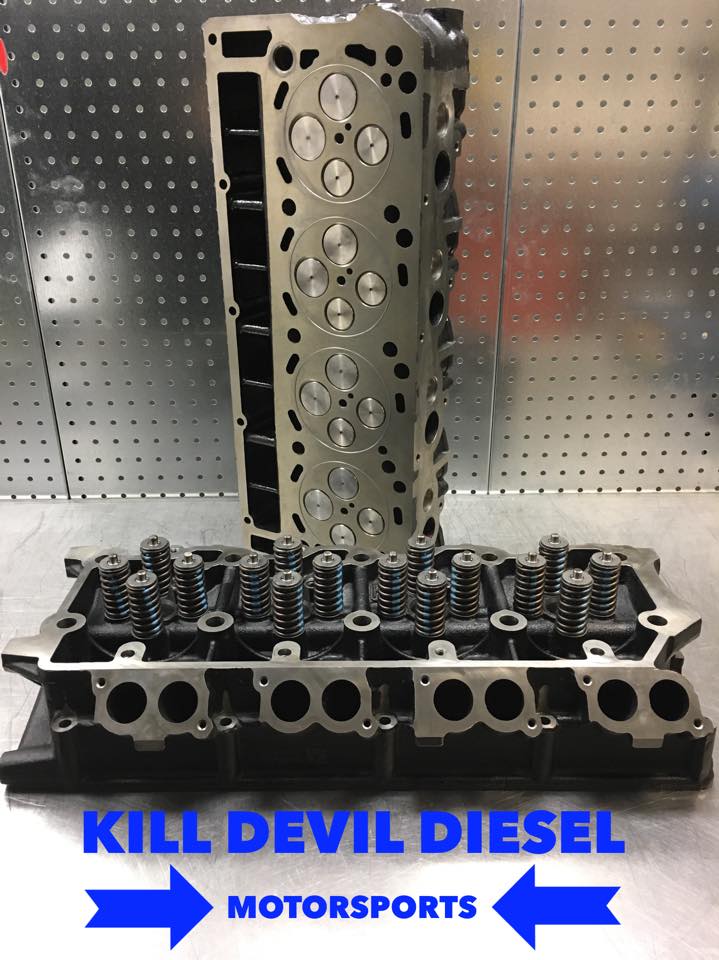

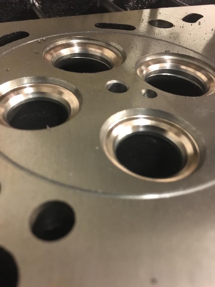

KILL DEVIL DIESEL MOTORSPORTS
So I pulled the trigger on the Kill Devil Diesel Motorsports O-Ringed heads.
I also decided to do a Stage 2 cam, performance springs, and performance push rods to compliment.
Shout out to Kill Devil Diesel Motorsports for the great response and discussion on these items.
Once they arrive in Alaska I can get the top end back together.
Any advice or forewarning on doing cams in a 6.4L or is it pretty straight forward?

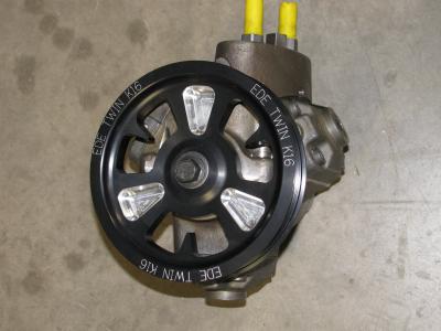

ADDING TWIN PUMPS LATER
I have the High Power Jr's, Fuel Bowl ******, and I'm not planning on doing twin pumps right now. I would like to potentially someday but just not right now. Any way to get injectors in now and do pumps later?
Is a modified modified K16/industrial II just not worth the risk of grenading? Any success stories out there? Stick to stock fuel, keep it simple, and do surrounding mods to reach 700HP?
Here's some info I found around the forum:
"Nozzles: With a single stock HPFP, the stock nozzles are basically maxing out the capabilities of the HPFP. If you decide to upgrade to a larger nozzle (even just 15% nozzles), you will have to modify the HP system or cut the PW to maintain RP at WOT on race tune (PW of 2.2 to 2.3). The only options available for modifying the HP system are a modded K16 or dual fuelers. The only modded K16 that is available is made by Industrial (II) and it is notorious for grenading and taking out the injectors, rails, etc. when it does."
" I can speak from experience that when I had over 90k on my 2008 truck It did not maintain on *******s 310 tune, with stock nozzles. Rykan I know there have been discussions about Eric's truck before, but his seems to be like the only one that could do it. The other guy that claimed to maintain eventually came back after realizing his truck did not maintain. IMO it's not worth the effort or money for the miniscule gains, potential for draining the rail on a stock hpfp setup, and potential for premature pump failure due constant high duty cycles and draining the rails. You can put them in and dial the pulse width back, but what's the point of putting nozzles in just to dial it back?
You're better off doing a modified pump or duals and running 30% if you want to run a 67fmw or 371."

sootie
Oct 3, 2012
11,853
39
Not worth the effort to do nozzles now and pumps later. Biggest you could run with pulsewidth pulled waaaaaaaay back is 15% which is useless (way too small) once you go dual pumps.
dont do a modded single pump, unreliable as heck.
leave the nozzles stock if you arent doing dual pumps. If you go dual pumps, dont do nozzles less than 60% over or its a waste of resources. The parasitic loss of running the second pump is hardly overcome with 15 or 30 over injectors.
akf250
Sep 14, 2011
156
Pumps
Thanks for confirmation on cost benefit on injector sizes Sootie

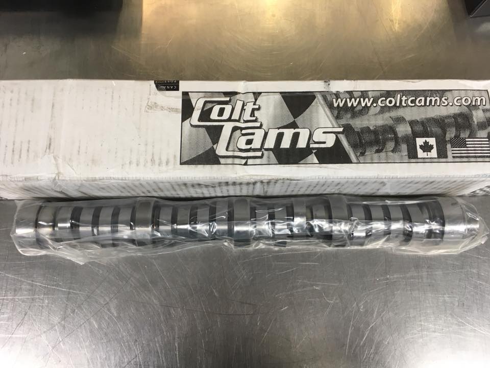

Stage 2 Cam Upgrade
So I decided to do a stage 2 cam while I'm this far in and I'm a little freaked out I'm gonna have to get a lot more technical than I would have liked.
Can someone please explain to me the difficulties of a cam swap in a 6.4?
I understand that if marked properly the crank does not need to be touched.
What are the steps of a swap?
If I'm replacing the front cover, will I be right there to swap? Does the transmission have to be dropped?

Roccafellas
May 7, 2017
357
Cam comes out the rear.. so you’ll need the engine out..and the transmission for sure has to be out of the way... you have to remove the rear cover, And it’s not the crank you mark it’s the crank adapter.

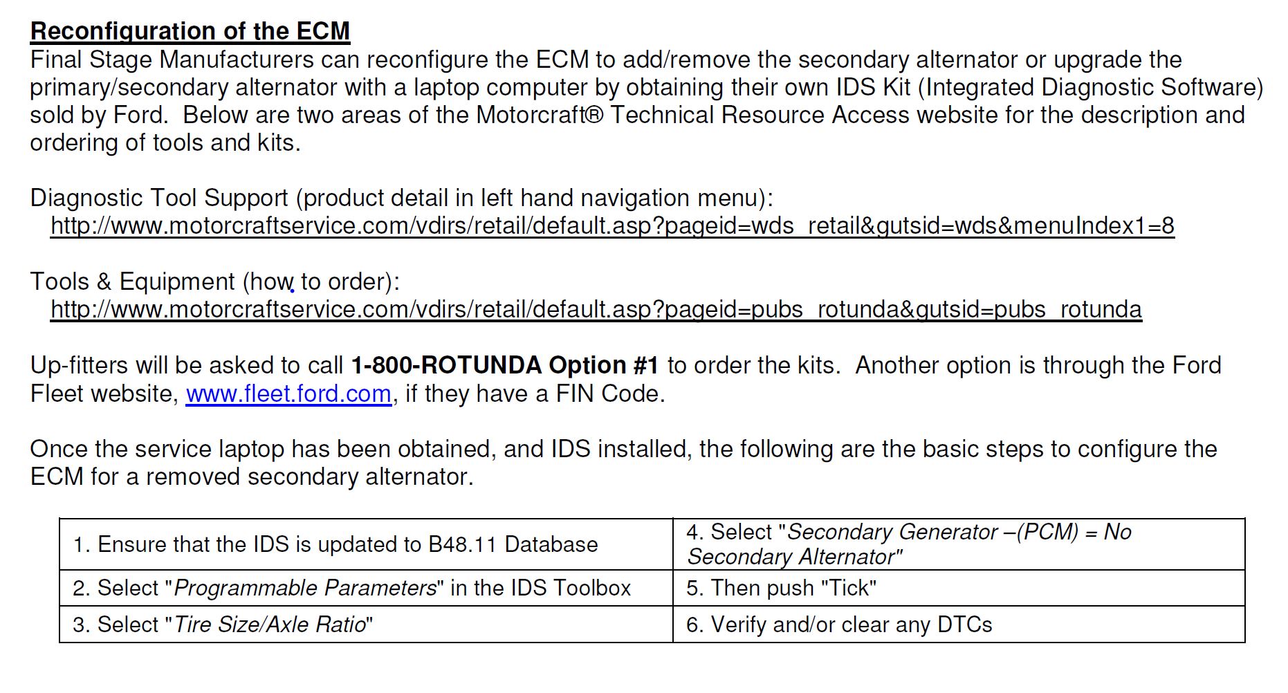

Dual Alternators
Anyone have any experience with the dual alternator setup for 6.4l's?
Pretty straight forward? Is the other alternator plug already built into the harness?
I have the service bulletin and part numbers for the upper alternator and longer serpentine belt.
Can I wait til after startup til' I can drive it over to the dealer for a ECU flash?

sootie
Oct 3, 2012
11,853
39
You will need to turn with dual alternator function on with ids

Got words that my new O-ringed heads got machined today and will be assembled tomorrow, hopefully ship next week. Front cover removal and surface cleaning until the weekend.
