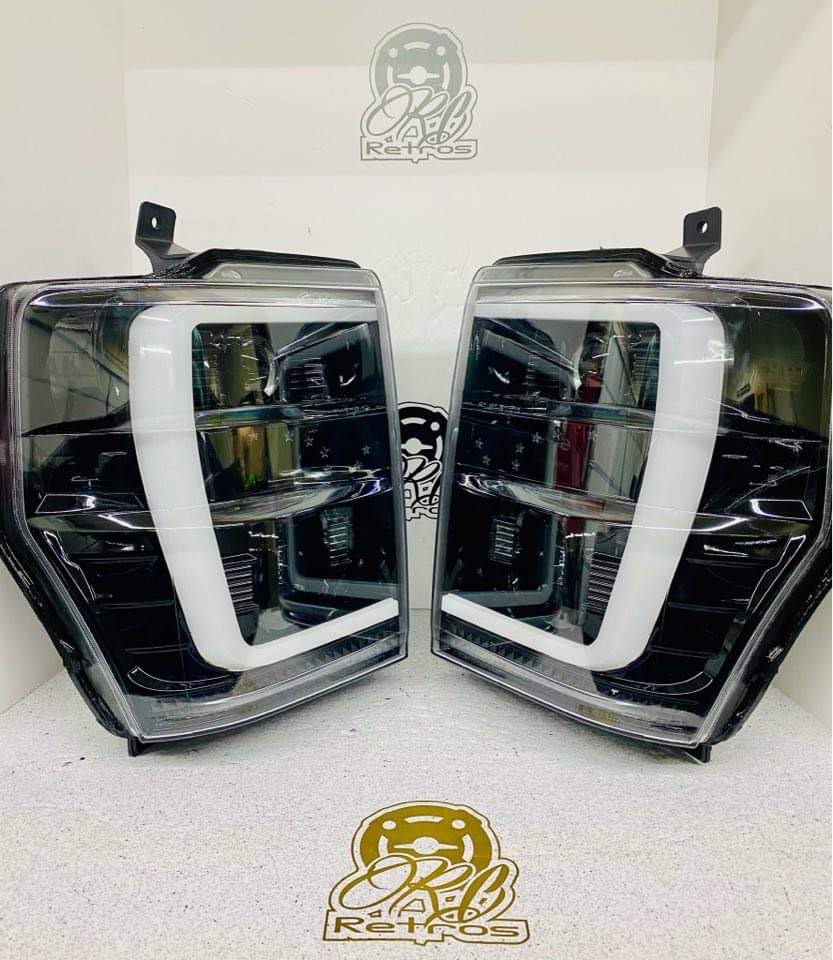

Besides that I have been mostly redoing interior creature comforts. Dynomatted all the door panels and installed a new stereo system all around. Re-worked my wiper cowl, painted my taillights, and started to redo the lights on the front bumper.
