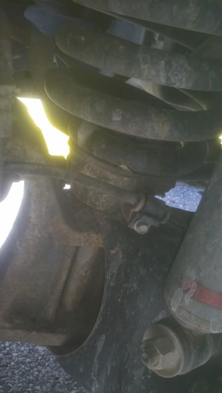

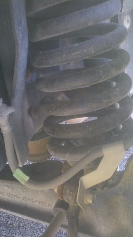

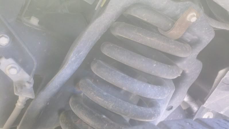

Looking at it more, it doesn't look that bad really... If there was a 1/4 coil more cut off, it wouldn't be nearly as noticable.

hmmmm. I might just go pick up some 6.4 springs and see for myself then LOL. I just want to make sure it is secure as I do want to get up to some higher speeds with this truck

Took some referance pictures today. Hopefully the '12 setup is the same as 99-04.

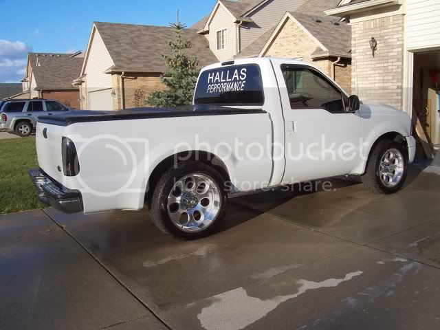

I know djm is pricey but why not do it the right way. That kit really dont give it the slammed look. Wish it did cause thats what I want for my truck. All that was done to my truck was 1 leaf taken outta the rear and the rest de arced. The front springs are stock I believe. I wanna do the 3/5 drop or maybe a 4 link air ride in the rear with djm's front dream beams. Heres a couple pics of what it looks like now.

I'm confused by your post Jeff. What exactly are we looking at in that picture? Are you running a or isDJM kit or is that stock with the leaves removed?

Jap, I just wanted to show him the stance of my truck with just the rear lowered to give him an idea.

No problem, that is a clean regular cab short bed. I'm jealous LOL. And I will take pictures of everything I do when I go to do the springs.
