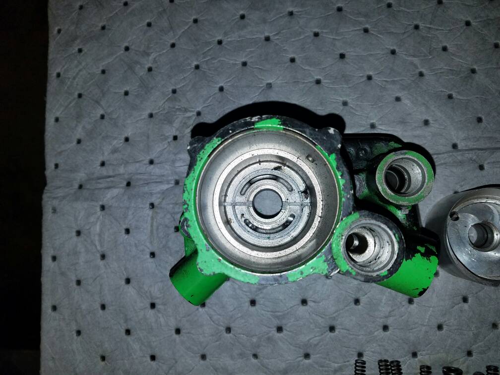

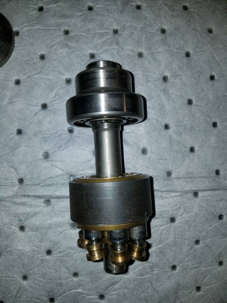

Here it is. The swash plate end plug has some marked on it from someone trying to pry on it. Everything else looks OK I guess. Not sure what it's supposed to look like. Also looks like it's complete. Hopefully DP can make it work again at a reasonable price.
that's all that is inside a hpop? never seen one apart... looks Chinese to me.. lol
live life full throttle
Just some pistons, springs, swash plate, swash plate plug and housing. Open up a power washer sometime and you will probably see the same kind of setup. Here is a good writeup on the disassembly of one. Mine looks a little different (which it should).

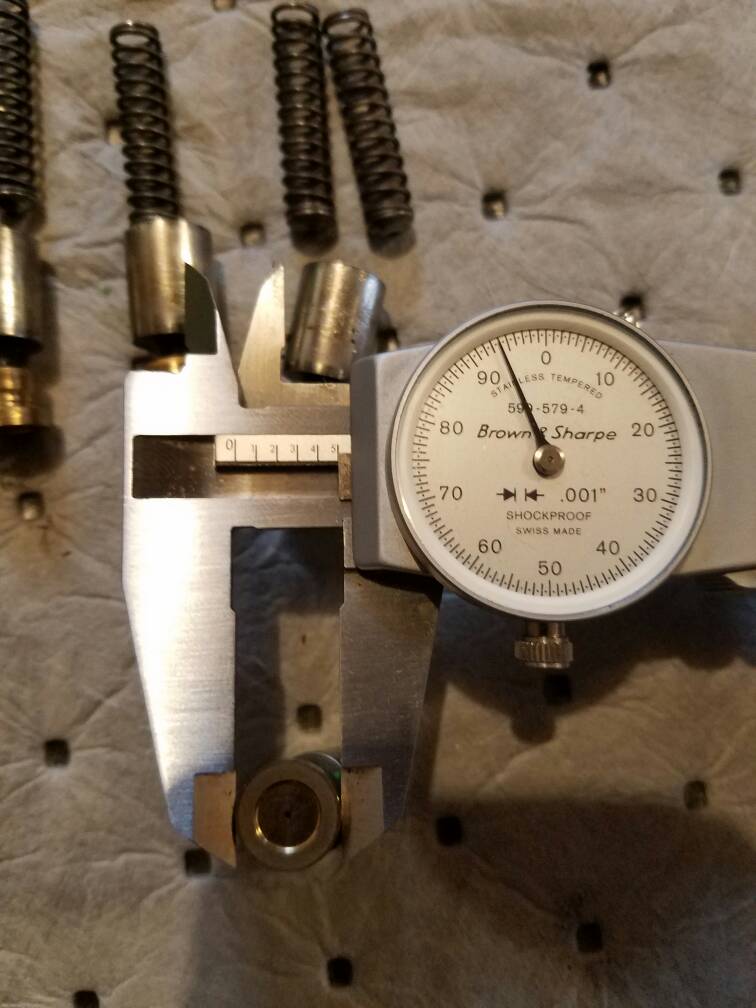

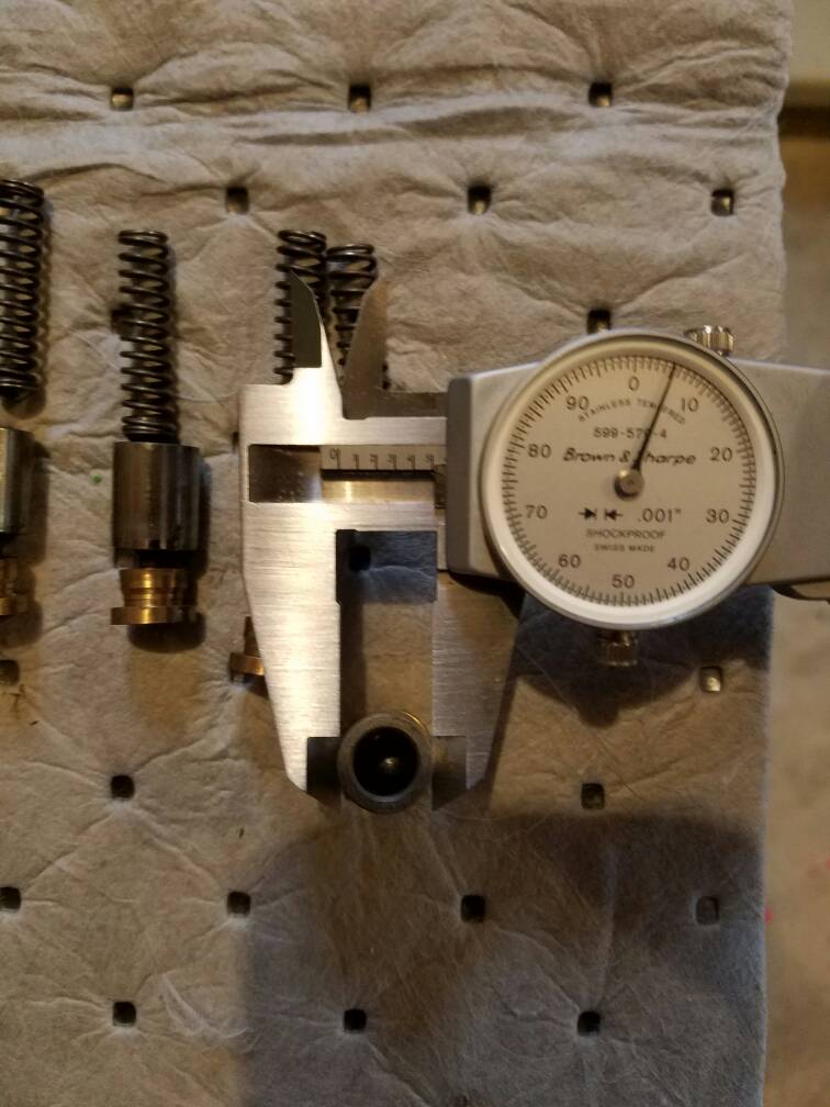

mine doesnt have that metal band around the barrel.
did you measure the diameter of the 'pistons'?
.437 is stock .500 is srp
the only thing that can fail other then the factory housing is the springs.
if you find a source for replacement springs let me know.

I like that link
it appears they have a snapring to retain the guide plate around the feet of the 'pistons', I do not recall that on my pump

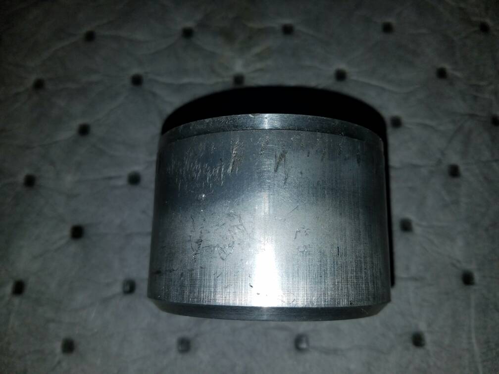

Took these this morning. That band looks to be made out of something much stronger than the brass? I suspect to hold the thing together since they remove a significant amount of material to accommodate the larger pistons.
