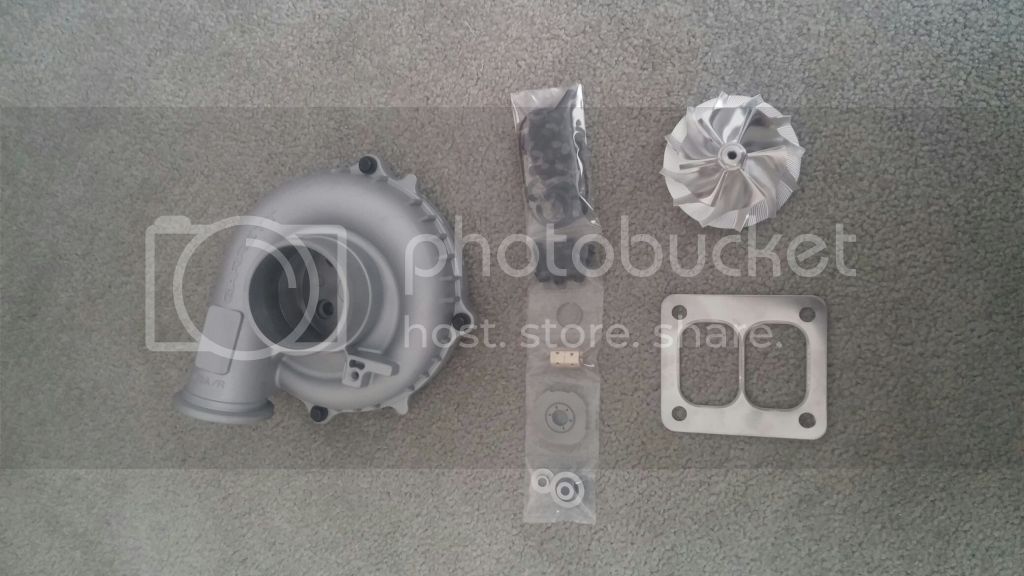

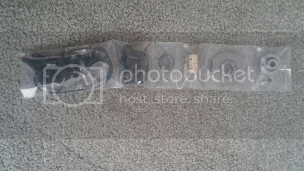

Got my obs kit in the mail today. James had this shipped promptly and everything was packaged very professionally. Its gotta be damn near impossible to beat what James charges for this if you don't want to spend the money for a t4 setup. I'm stoked to get this on! By the time a guy bought a 1.0 housing, ww2, and a rebuild kit they wouldn't be far off the diy d66.

You might have yours done before me. I put my turbo together this morning but I probably wont have it on till feb. or march. I'm doing all my "build" at once and I need to send my injectors in. I'm getting close though! All I have left to buy is injectors and tank side stuff for my e-fuel.
The riff raff OBS turbo rebuild kit document was a huge help. Mainly with torque specs for everything and what to Loctite.
