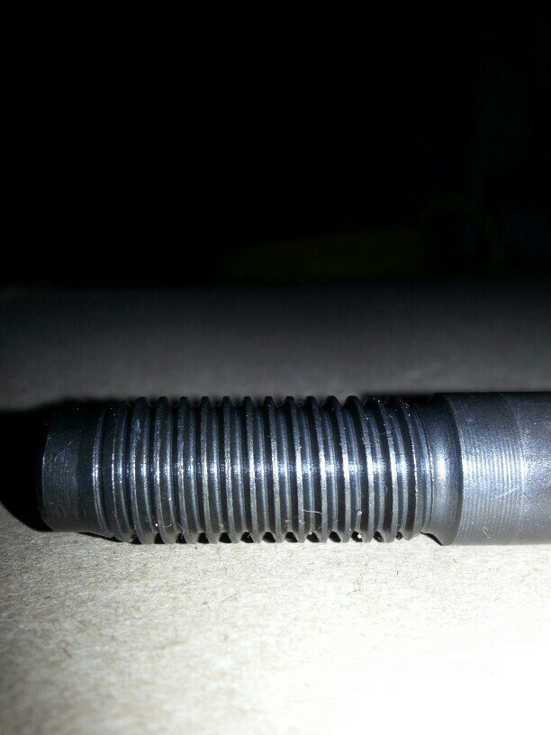

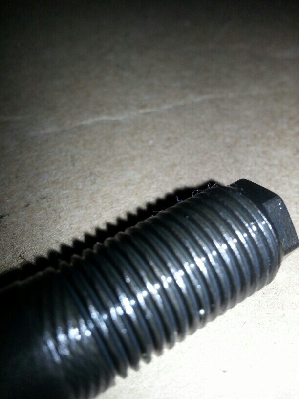

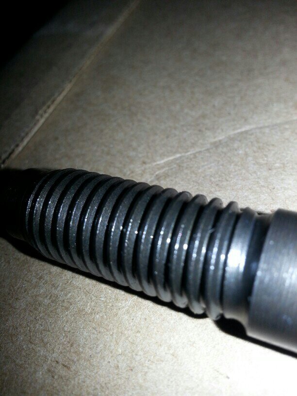

I seen the comment from a guy earlier in the thread, he was talking about the threads not looking clean on these Extreme-studs. And he is right about that causing inconsistent torquing. Can someone provide better shots of the threads?

I don't really know what I'm looking for but they look clean to me.
