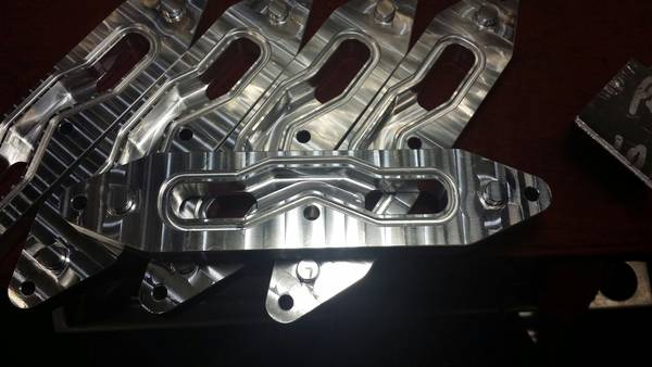

Our two piece billet manifold plate is has a cnc machined water jacket in each plate. Giving the coolant a place to flow through. Rather than dead heading a system, we chose to go this route to allow the factory coolant system to operate like it was designed, as much as possible. I.e., not dead heading primary system coolant ports. When I first came up with the kit, I never anticipated to see a drop in ECT with what I had. After some testing done on 3-4 different trucks, all wîth varying setups, I found a average 3-4* drop in temps. Needless to say, I was thrilled. I'll see if I can upload a couple pics of the primary and secondary coolant system breakdowns by Ford, just to show how taxed each system is and why I got excited that we were able to come up with something to benefit the truck in more ways than just removing the cooler. Also, like anything else in this industry, there are people who think our kit is a unnecessary expenditure and see no reason why a drop in ECT could happen, would happen, or is worth happening. So I tell people this; for the benefits we found in testing and for the basic principal behind the kits function and form, I went forward with production, because I believe that it works and will work for everybody in a beneficial way. Whether you find the same to be true or not, is up to you. As long as you make a purchase that makes you happy, that's all that matters.

Yeah, I was referring to the primary side temp drop we saw in testing over the blocker plates. I'm sure if anybody besides me and the handful of guys who helped me do testing between the two kits, had posted the gains or were selling the kit, it wouldn't be refuted or copied. But hey, look forward to seeing what a 3/4 end mill path does for temp drops. I've exhausted testing on mine. Very happy with the results
well , the flow thru plate is done . I still need to test it, but it is now an option for my customers, bringing the price to $229 . I still feel the standard block plate is suffice, as I don't believe the coolant needs that flow - thru , but this is now an option when purchasing a no limit egr delete. we are also testing high grade silicone caps vs the flow thru hose as an option , as I don't believe the hose does much for improvement either.

It's definietly worth the added cost. We've had great results with our flow through plates on several different vehicles all yielding similar results. I tested a 3/4 mill path on steel plates as well, and the gains were there but the port matched plates we sell seem to be a little better for results. Either way, you won't be disappointed no matter what way you go if it gets rid of that Chinese stuff you have now :)

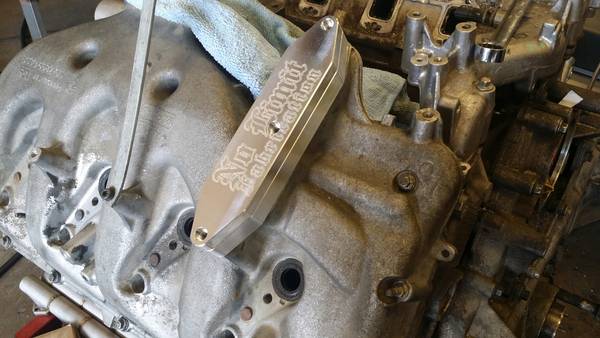

Damn! I'm not sure how it looks installed, but it looks awesome right now. I'm interested...
