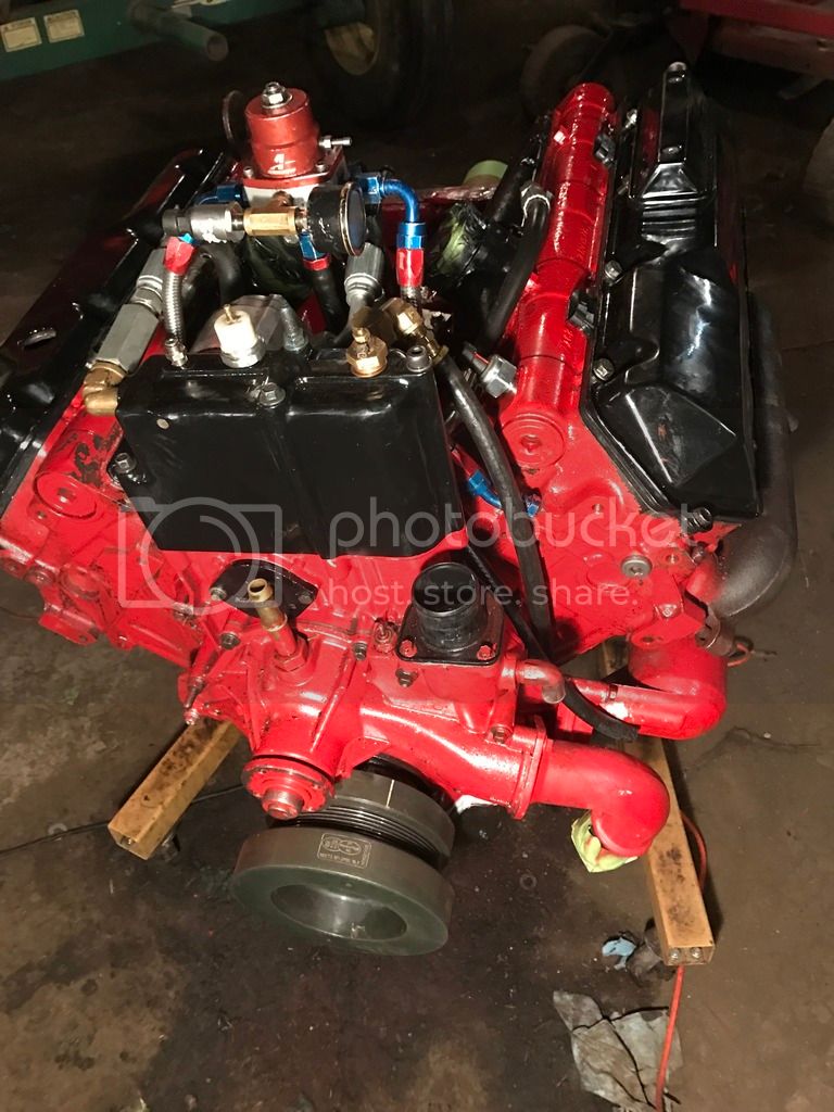

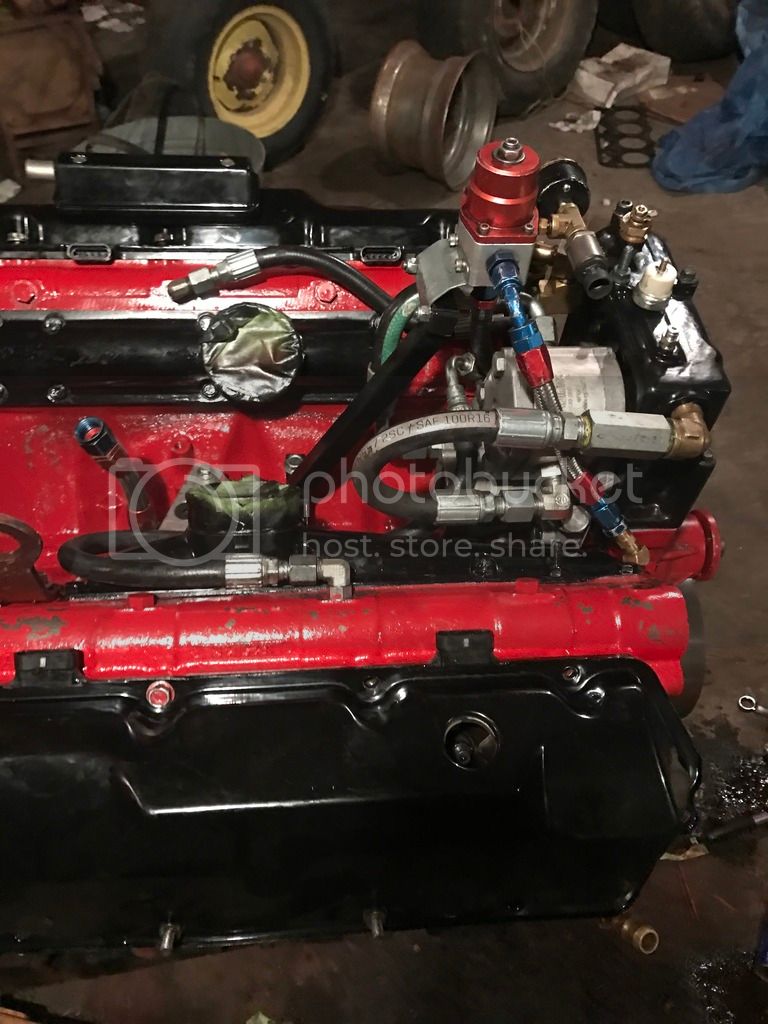

Putting stuff back together. Threw some paint on. This is as good as it's gonna get. Paint won't stick to some places.
