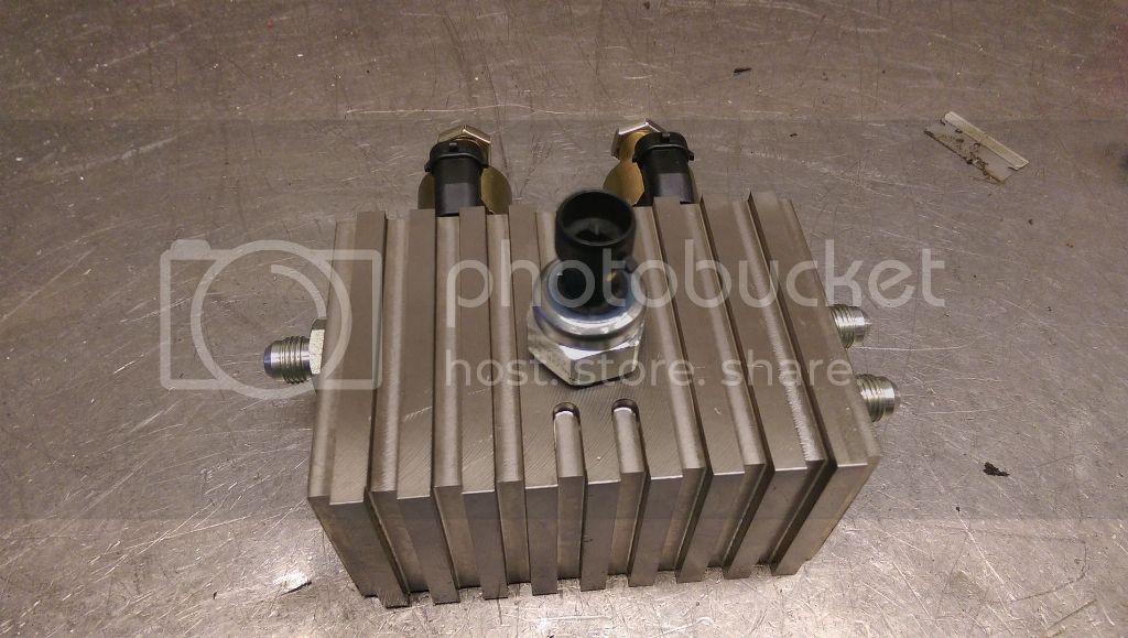

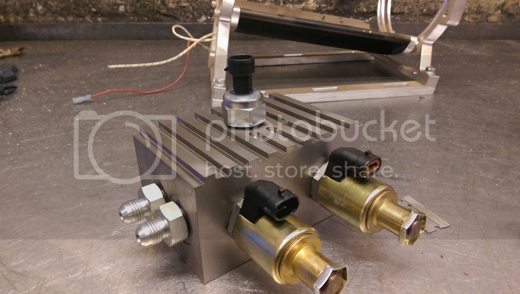

Mine that i made. Had a few people ask for one just haven't had the time.
Wow that's looks really good! Can you explain how it works? I kind of have an idea. Maybe some more pictures would help too.
Thanks

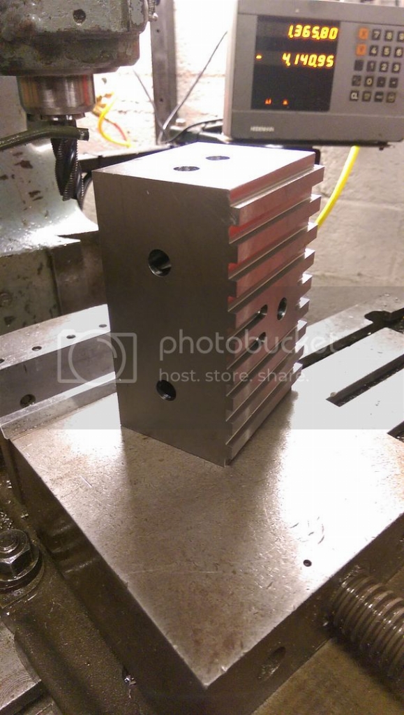

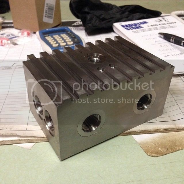

That looks beautiful. What mill (cnc or manual) did you make it on? What grade of steel did you use? I would love to try and make one. Also, are those jic to not fittings? It's interesting how you started the thread about an 1/8" down 8n the hole. I'm not a machinest, but I do some machining at work. I have never tapped npt threads that way.

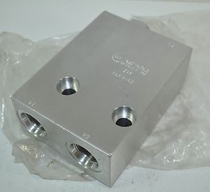

ja_cain
Aug 10, 2013
4,597
Something like this?

superpsd
Jun 10, 2014
1,928
3
Missouri
Only problem is the IPR valve is different than the average selector style dump valves.

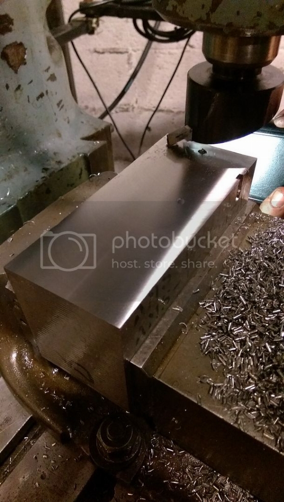

The treads are all ORB and mine was done on a manual mill. It's a block of titanium not steel. Aluminum would be fine.
ja_cain
Aug 10, 2013
4,597
I see the gold/bronze tint now. The one time I turned some titanium, I thought it cut like butter. I felt it was much easier to work with than the 316 I have machine all the time. That piece looks beautiful. Btw, thanks for the info about the threads.
