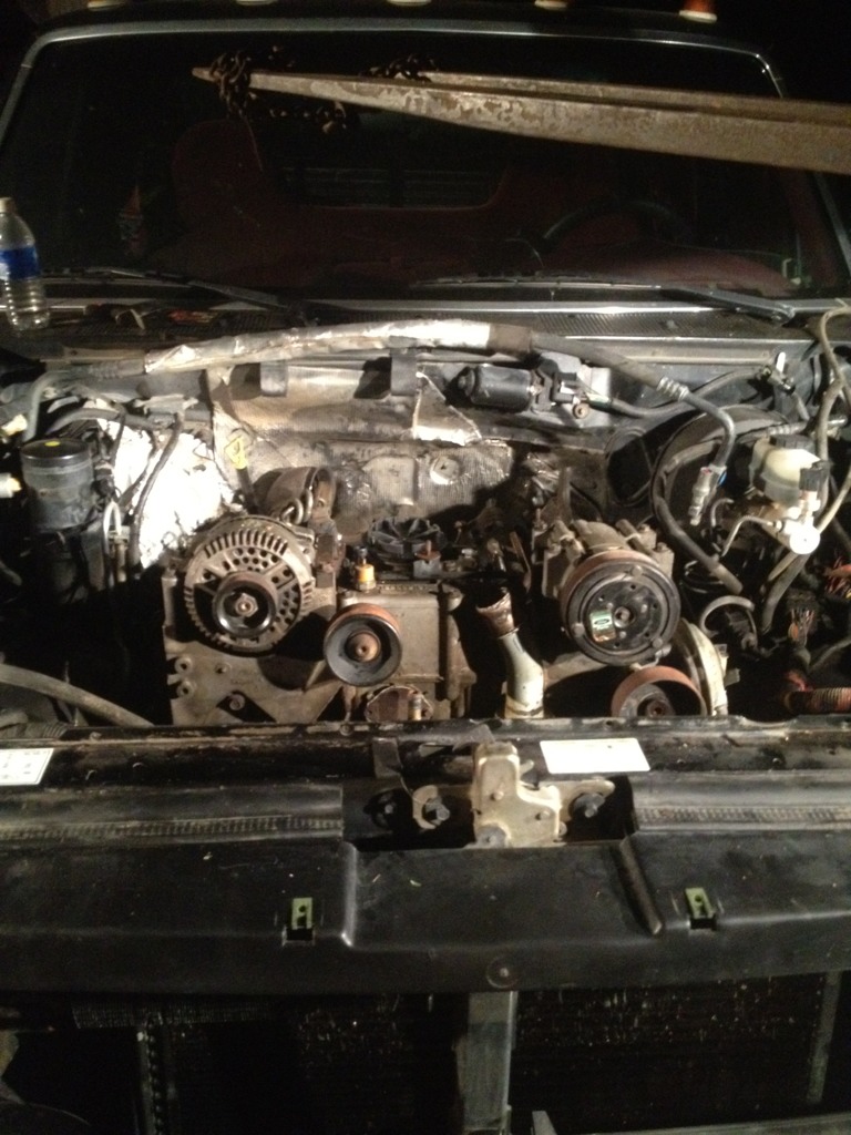

I spent a couple hours pressure washing the new engine, and pulling the turbo and up pipes. I decided I wanted to drop it in tonight so I can spend the week nights trying to get it running. It fought us quite bit but it finally dropped into place.

I got the tranny all bolted up along with the wiring harness. I dropped two batteries in and started to crank on it with no accessories. I had to use the worse of the two pedestals and tap to put a plug in to keep the oil feed from spraying everywhere. I wasn't able to get it to start or fire, I also wasn't building any oil pressure on the dash after cranking awhile. I know its gotta fill up the rails but I gave up for the night. I really hope the pick up tube in the pan isn't cracked, I'll probably put a scanner on it tomorrow so I can see what's going on with it.
