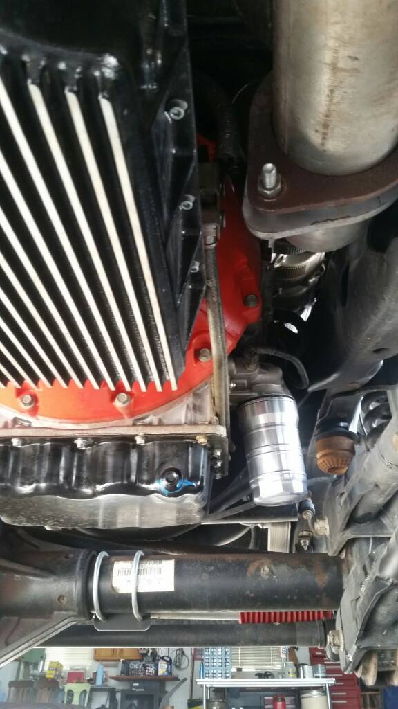

Fuel dripping off the bottom of the motor
Droplets of fuel accumulated on the bolts under the motor.

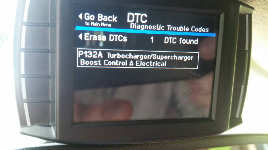

And I found why my waste gate wasn't working...

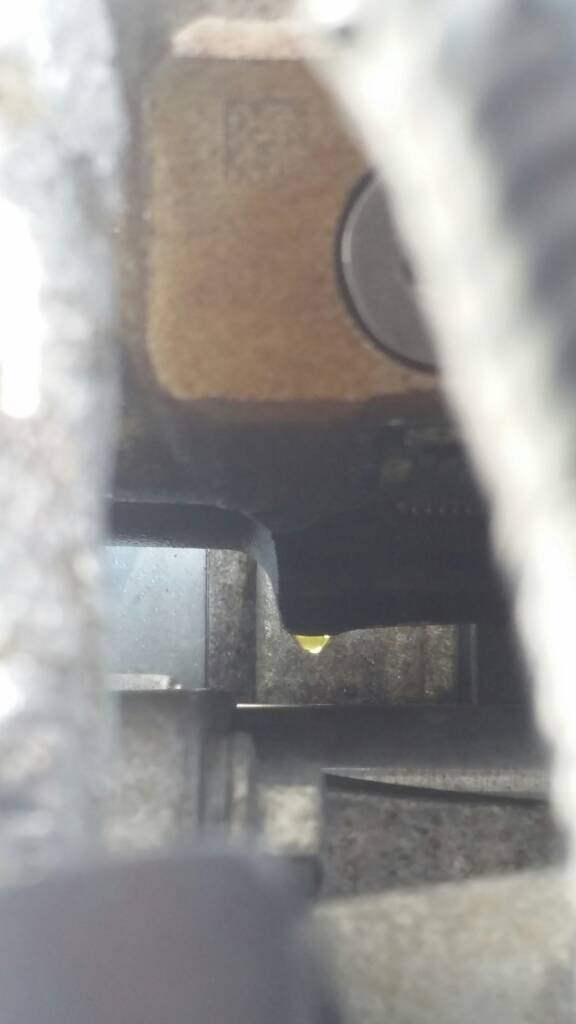

Mmhmm... knew it. Now to see where exactly on the cp3 it's coming from. Hopefully it's just a loose hose and not the seal on the cp3
