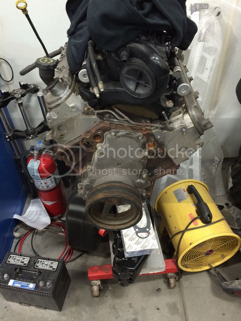

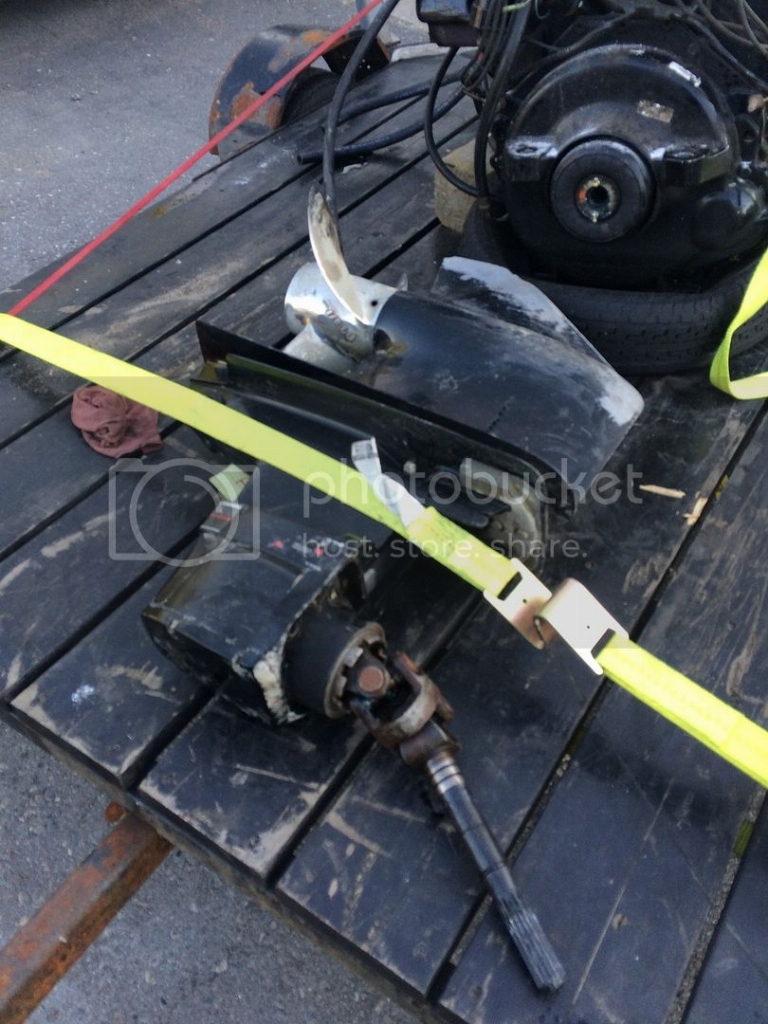

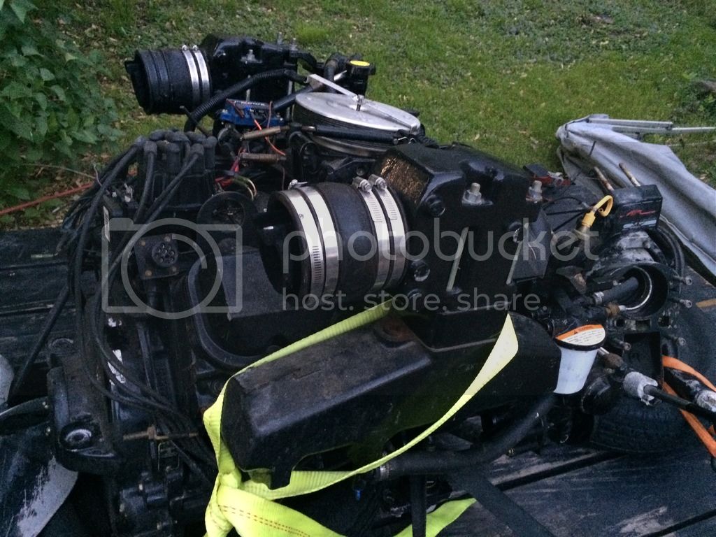

Got a LS1, picked up some PCM manifolds, and made a big score last night. Picked up a Bravo 1 with helmet and a BBC for 2k, going to sell the BBC as it wont fit in the boat. Going to start the tear down of the boat after labor day and be back on the water in spring. Will be running a GM computer with EFI, now that my drive will support more HP I'm looking for a small supercharger for it. :)

Motor came off the dyno last week did 404hp and a pretty flat TQ curve. Getting exicted to get this thing done and drive it.

Sweet mother of God this thing should scoot along pretty good lol
