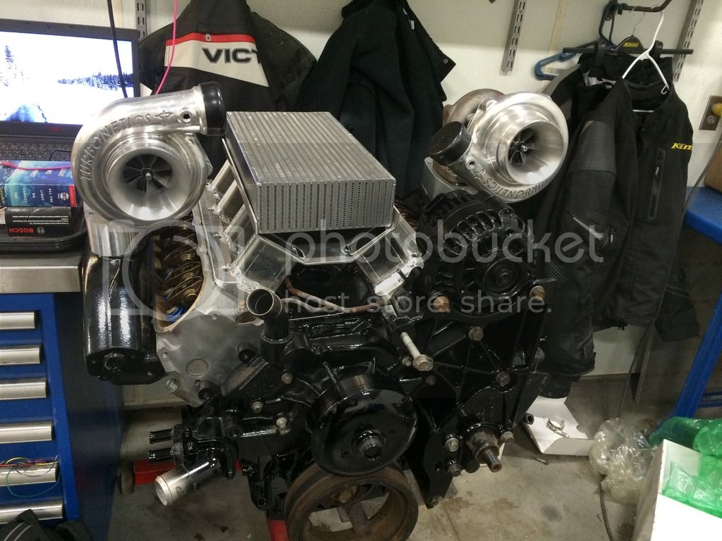

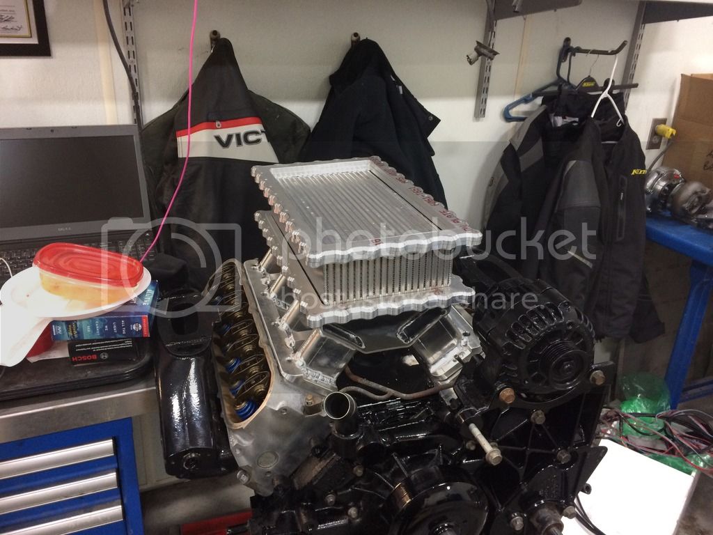

Thought I would update since it almost spring and the boat is starting to come together, well atleast the motor is.
This is what I have so far
Gen III 5.3l steel block
"built" bottom end Cant remember everything that has been done as it was over a yr that I built that.
LS9 Cam
GM Blue Springs
Heads have been cleaned up valves gone thru.
Intake is a custom piece with built in water/air intercooler
Twin Turbonetics Super 62's
This is all going in a 25' Pontoon :) :).
Should be 550hp at 8psi.

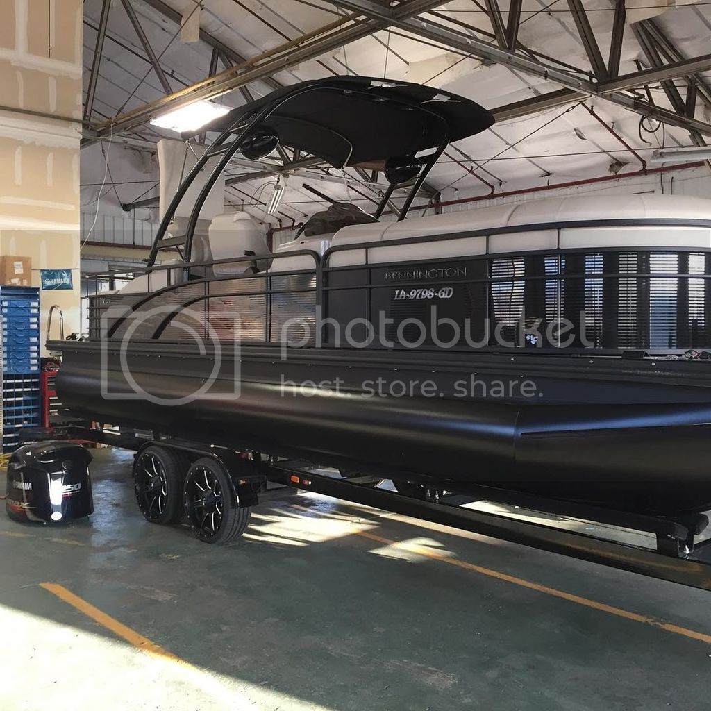

This thing is going to haul ass across the water. I saw this on instagram and it reminded me of yours
TurboM700
940
Minnesota
That thing is sexy right there, my toon are getting paint black as well no more polishing toons that sucks, aint go time for that have beer to be drinking.
