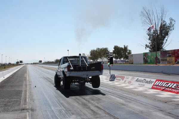

someone needs to post the video of that obs with caltracs and the rear tires a foot off the pavement just off the line...
I saw that picture in another thread when trying to see if it's been brought up before. They were all really old threads and not a whole lot of feedback.

That was on the balloon tires too that he was running at the time. Believe there was WAY more at play there than just the caltracs.

I had an old video of someone just driving around town with caltracs on. Same exact thing happen as that OBS truck above, you could see daylight under the tires it was hopping so bad. The video disappeared off youtube. It wouldn't matter if the truck was a 2wd or 4wd.
Plus they don't work in reverse. So if you are backing up a trailer they don't do anything.
werd^^^ dealbreaker for me as i spin in reverse ALL the time esp with a trailer on.
