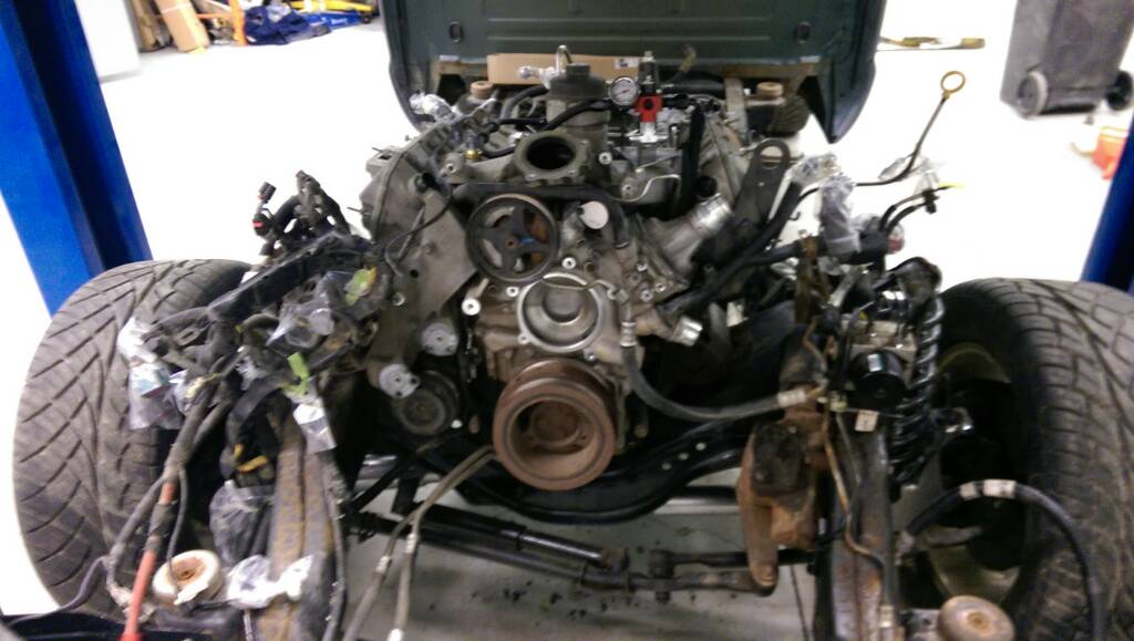

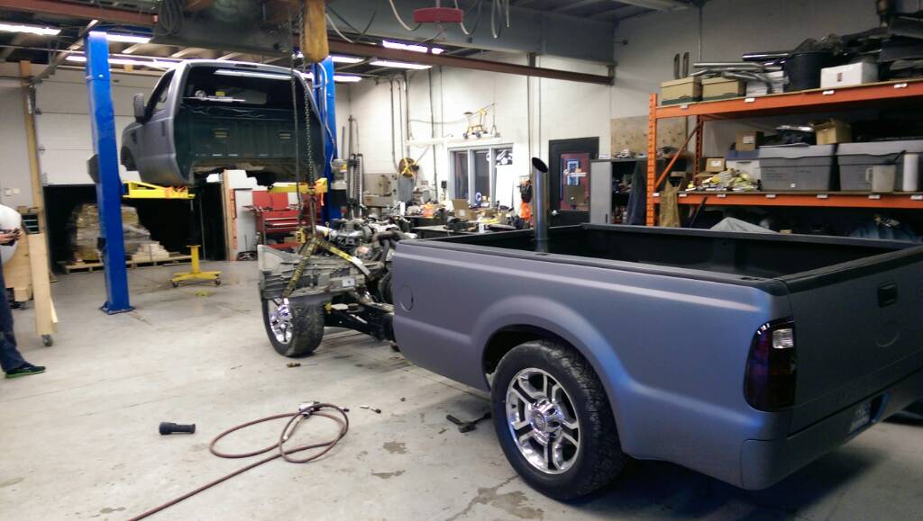

Made quite a bit of progress this afternoon, more than I expected. I was pleasantly surprised at how easily things came apart on this truck, had the cab up in no time, tranny is on the ground and ready to be sent out, and the majority of the motor is stripped, should have it down to the block tomorrow night

It's matte silver from 3M, their 1080 automotive vinyl Morgan, I use it quite a bit, heck when we repaint equipment now (CAT's) I do the black in vinyl, much quicker/ clearer.... And I have thought about a shorty Ty, maybe during the winter but the look is really growing on me as it is... It will get back halved at some point though

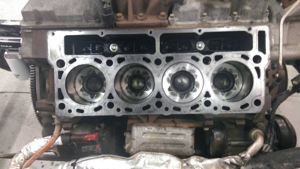

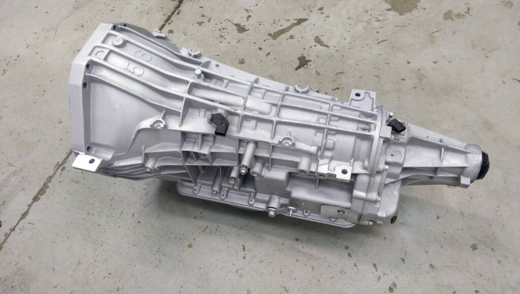

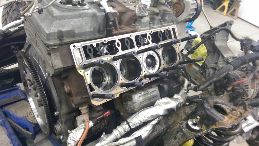

Made some progress on Friday, was hoping to get farther along this week but Easter events have prevented that, got the heads back and the tranny is built and back. I tore it all apart and was pleasantly surprised with the puston/bore condition. Passenger side is studded and all back together, drivers side is almost done just need to paint the rocker box and valve coveruploadfromtaptalk1398030240647.jpguploadfromtaptalk1398030266829.jpguploadfromtaptalk1398030284498.jpguploadfromtaptalk1398030323813.jpg

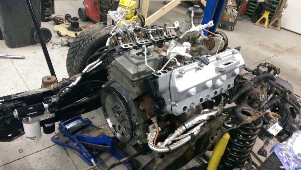

Last week I also got the fuel lab mounted and most of the fuel system mocked up, just waiting on a few fittings uploadfromtaptalk1398030409248.jpguploadfromtaptalk1398030435925.jpg
