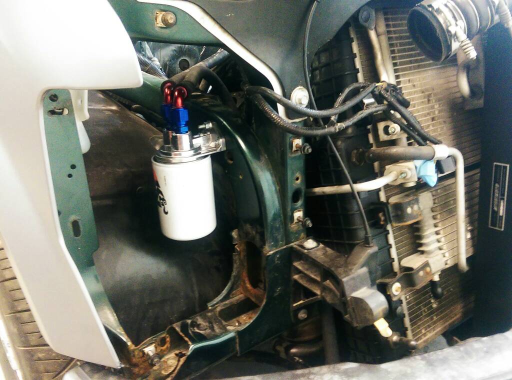

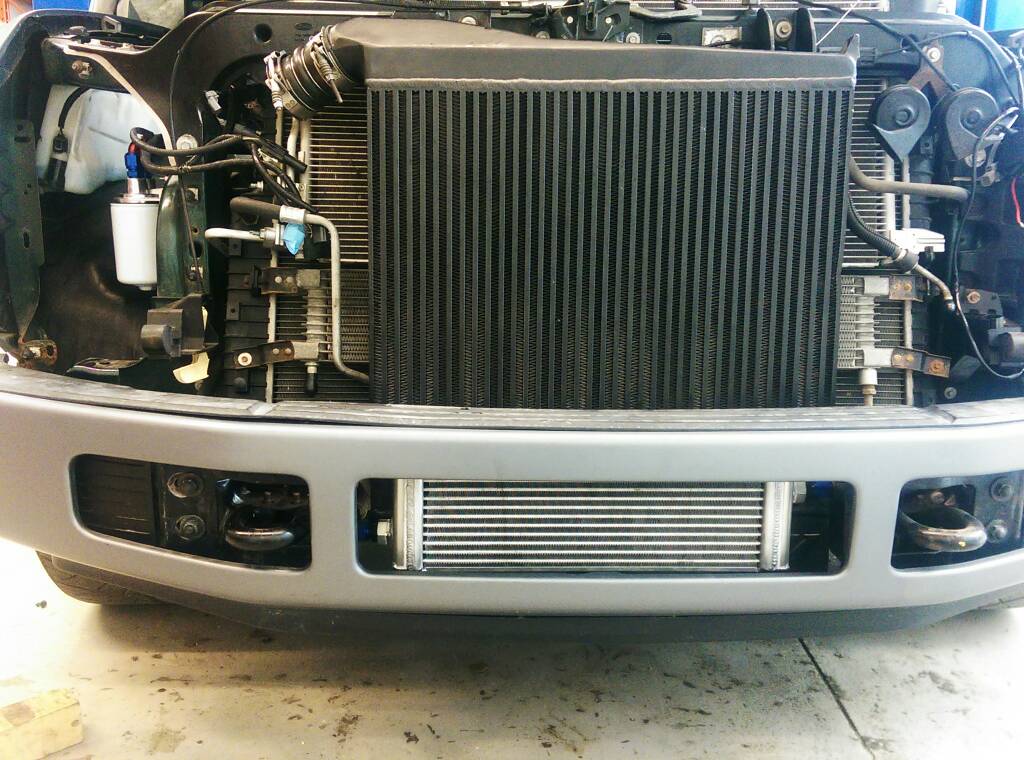

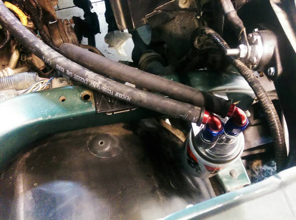

Spent a couple hrs tonight getting the oil filter / cooler set up in place, found a clean spot for the oil filter behind the passenger headlight, thought it would keep things clean and out of the way, I need to make a couple brackets to mount the cooler up front but it fits nicely up their and the lines fit well once you plan things out... It's all pretty simple but looks clean and will open the engine Bay up even more.

I'm sure it will spill some but I don't think it will be a big deal, can't hurt anything their it will just land on the inner fender, just put a couple rags down ahead of time I'm thinking.... I guess we'll find out!

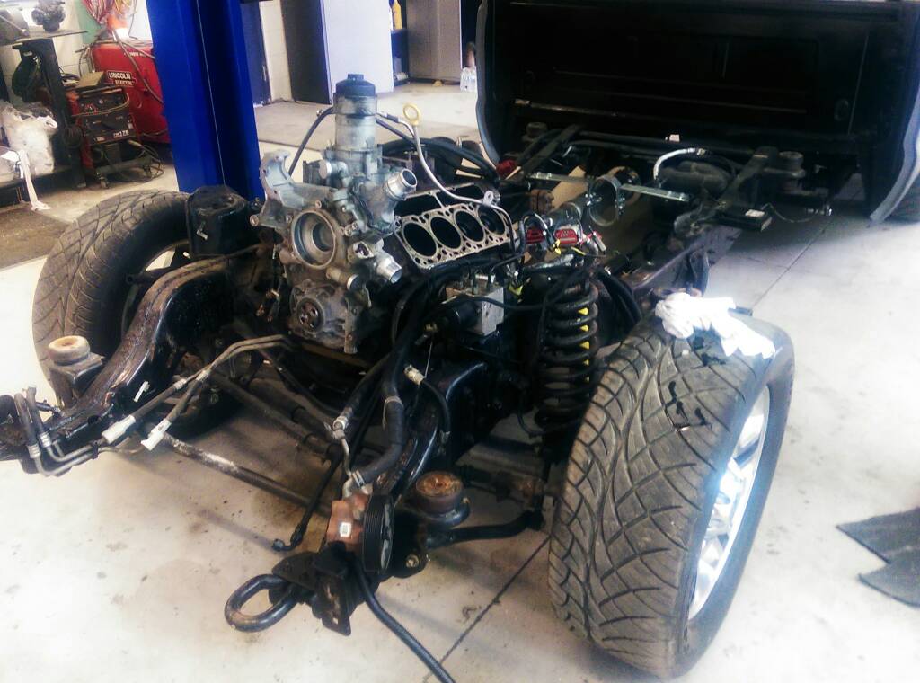

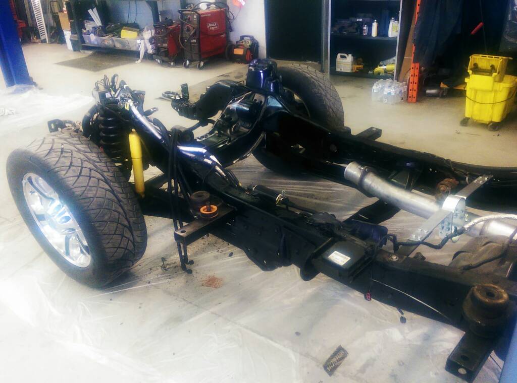

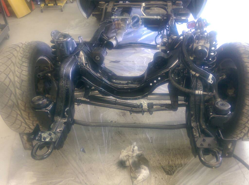

Quick update here, Morgan got everything assembled and the last few peices arrived today at his shop for the motor, I'll be leaving bright and early tomorrow morning to make the 11hr trek to pick it all up!
Over the weekend I pulled the hurt motor out, and cleaned/ painted the frame, along with the under side of the cab so it's ready for a new heart.

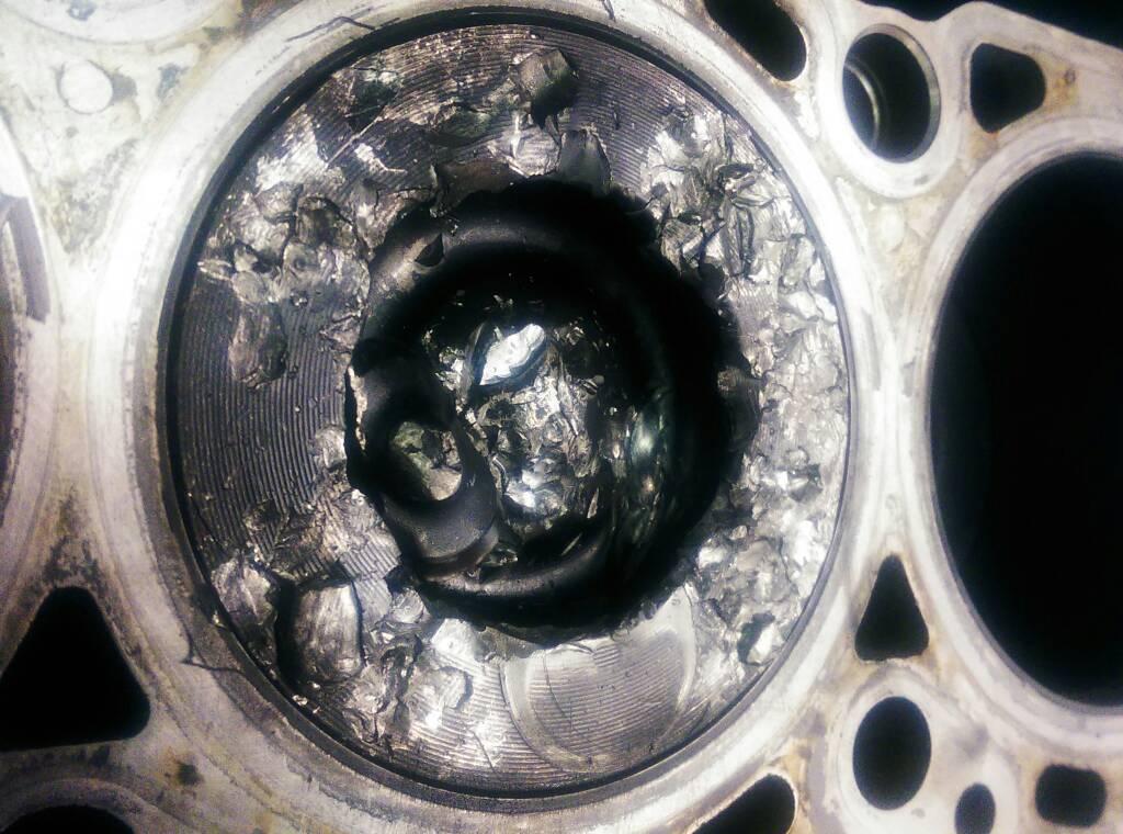

For Sh#ts and giggles I also pulled the hurt Piston/ rod assembly out, the top looks like swish cheese but surprisingly everything else was fine, the bore is scored but could be reused with light machining

Holy ch#t...you Canadians don't half a#s f#kin up a piston!!!
