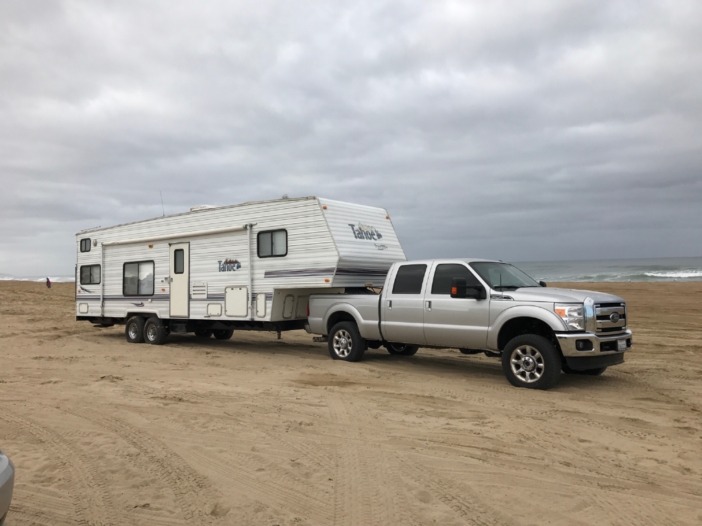

What a night and day difference! But damn the factory leafs are such a buzz kill. Took it out to the dunes this last weekend and huge difference from the stock ride. Tows like a dream too, pumped 50psi in the bags to somewhat clean up the rear sag.
