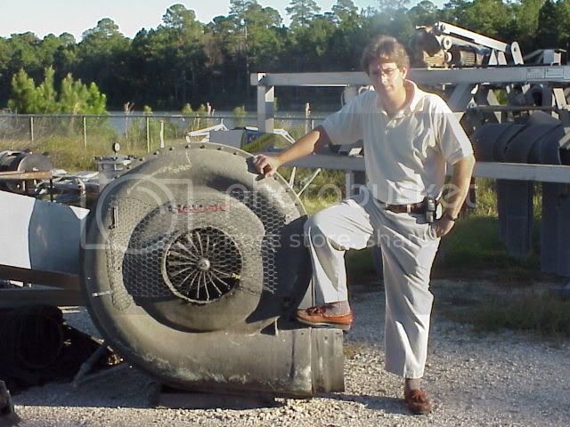

dude, just get one of these and be done :jammin:
