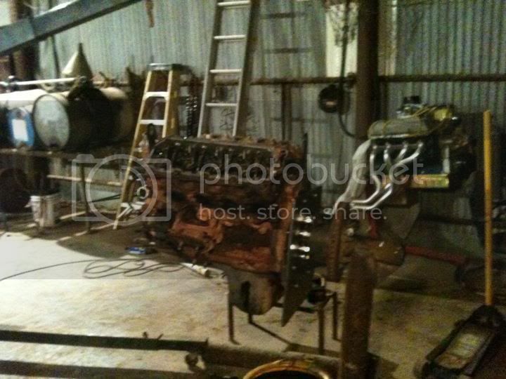

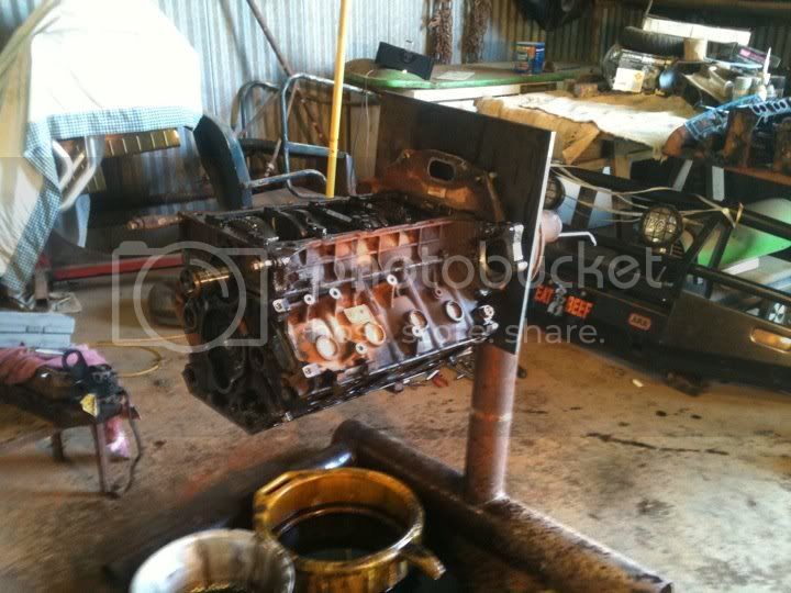

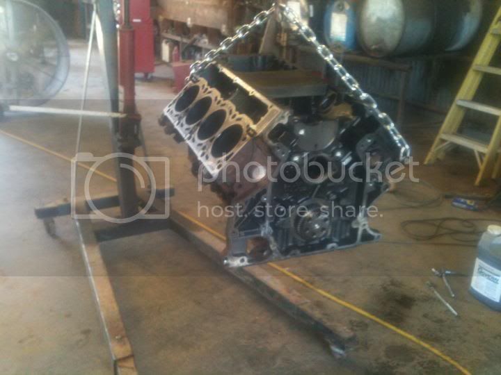

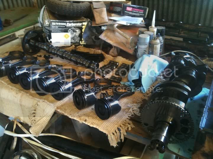

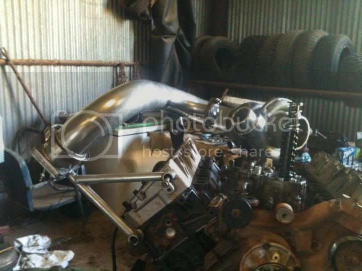

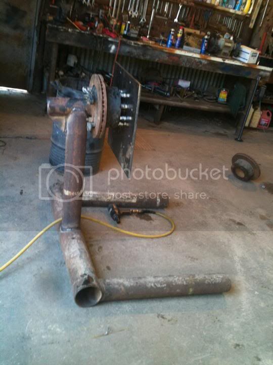

I just realized I didnt post the pics of the build!
well here they are
this is the engine stand I made (thats the end of a sterling 10.5 axle)
ignore the dirty truck

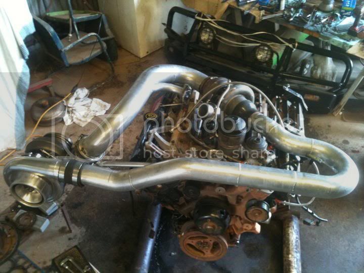

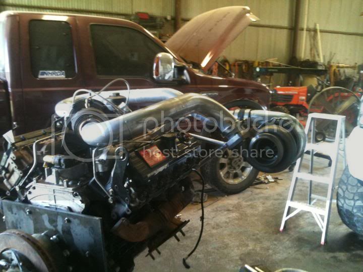

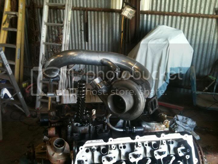

Looks great. Love to see more guys doing things themselves. Nice work how much boost are you seeing. You should have between 60-70psi. Do you have an external gate. Check your back pressure, you might have to restrict the gate a bit to bring up your boost #'s as long as back pressure don't get crazy. I mean if you see 70-75psi back pressure and 65 boost that's fine
Cutting-Edge Diesel
Feb 10, 2012
5,738
Newkirk, OK
I'm only seeing 50 psi so far. I think I have a boost leak around the intake elbo that I can't locate/fix. Also I think my high pressure is needing a rebuild kit. Could that hold the boost back? I don't have my gate fabed up yet. That will be soon tho.
