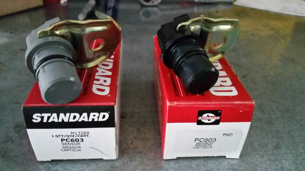

I ordered a second Standard CPS off Ebay for under $10. The second CPS came in gray. The box for the gray sensor says it's made in Mexico. The box for the black one says made in USA. The USA box appears to be an older Standard box logo design. Hmmmmm

I could see the magnet from the bottom. I put the black one in today. Truck idles smoother. The magnet is definitely stronger that the Ford gray recall CPS that I removed.

When I removed the Ford gray CPS, it was shorter a few thousands vs the black old style CPS.

pretty sure, like I posted the pics above, the black is the only one that needs shimmed... I took out the black cps and replaced it with a gray cps and a couple shims I got off ebay, and I can make it loose signal around 3400 rpm so I need to take a shim out... the black cps is longer and would require more shimming.. with the wax paper as shims, I could still run up near 4k smoothly.
live life full throttle
That also likely means the timing is actually changing as rpms climb as well. My thought it the distance and therefore relative time gap would get smaller and smaller before it picks up the signal and thus time gap from where it should read to where it does increases. Again only a theory but I know others have checked and different cps do change the timing.

if you look back at a couple pics I posted you can see I measured the two styles and the black is noticeably longer even with the naked eye.
yep. pops like a beotch at 3500rpm. someone asked what the rev limiter was set at and I said its whatever the cps losses signal at lol.. should be good to go now.

so I installed the black cps with a .020 and a .010 shim and it is still to close. must be my wax paper shims where thicker cuz in this video of me pulling you can hear it cutting out and the cps intermittent code came up. my girl called it at the end too. kinda funny. wouldn't get above 3500rpm but I did end up taking first cuz the big boy of the class broke. and they reset the sled.. well added a 16 foot chain to it is seemed like anyway. lol
