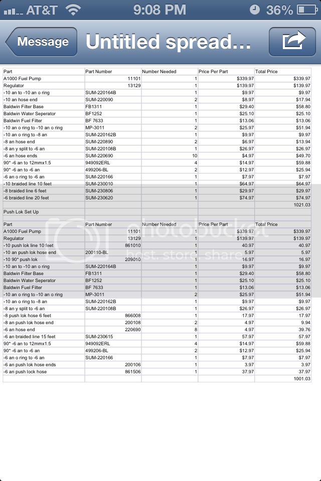

The list is getting expensive...
Jegs
Braded hose -
6’ 10an braided steel
6’ 8an braided steel
20’ 6an Braided steel
Fittings-
8-10an hose fittings555-100003
5- 10an ORB fitting555-100204
1- 10an-8an ORB fitting 555-110166
4-8an hose fittigs 555-100002
1-8an pressure fitting 555-100521
10-6an hose fittings 555-100001
1-8anY6an fitting 555-15165
8an hangers 023-FCM3485
1-6an bulkhead fitting 555-100560
SInister FP Regulator
a1000 pump
Total $1100
Summit
4x Head fittings 949092ERL
Total $60
Ebay
2-Baldwin FB1311 base
1-175-2949 water separator
1- 1R-0750 Filter
$100
HobbyStock62
Dec 20, 2012
483
Mpls, MN
its a screen shot from my iphone. the actual list is on a computer that is in a few pieces right now. how to i post a pic from my iphone?

From John ( Hobby Stock)
This is everything minus tank. I was debating between draw straw and sump and a way to return. I will probably sump it and then return it to the factory sender with -6 the whole way back.
