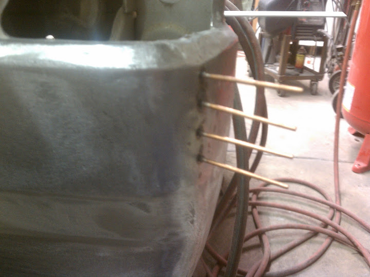

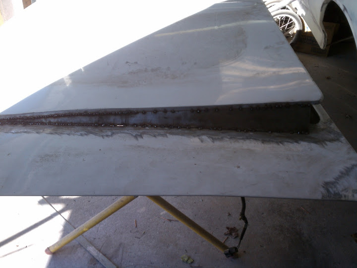

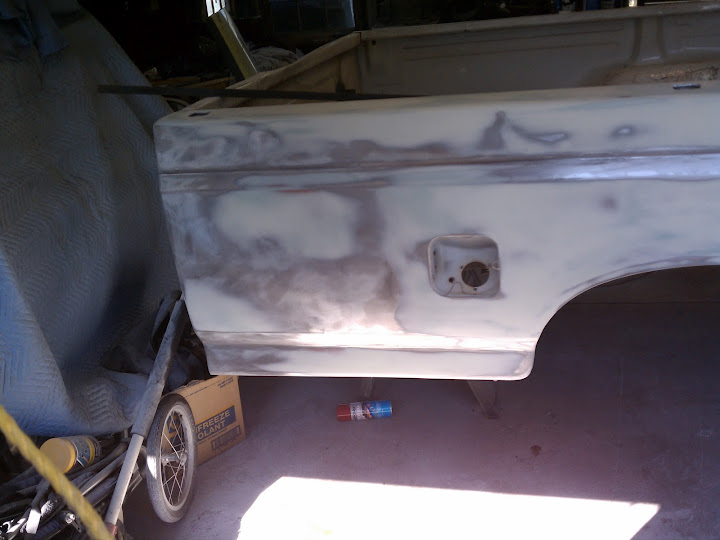

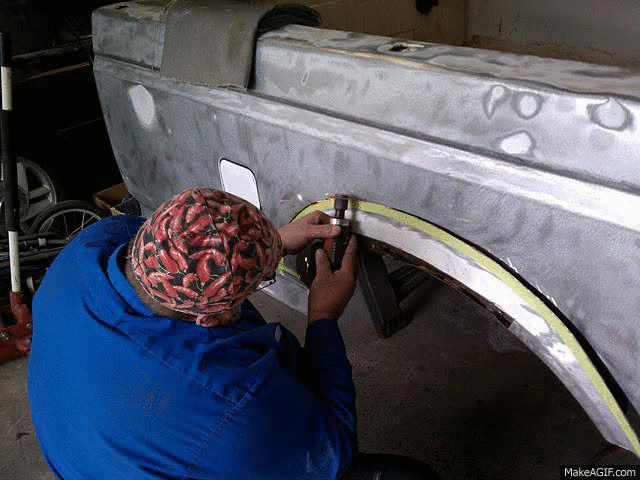

I didn't get done as much as I hoped to, ran out of welding gas, air board wasn't working right, and the water separator was causing issues. So with the compressor issues fixed, we are good to go.

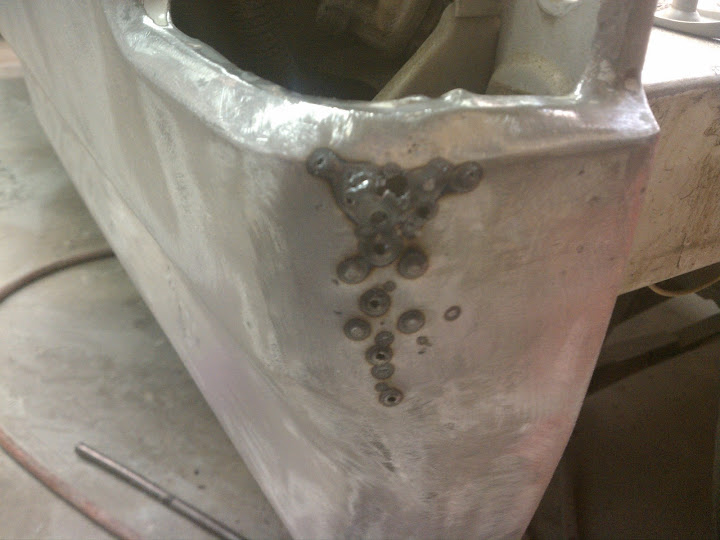

Studded up, ready to pull the corner back out.
OOps? Studs ripped out.
Welded back up.

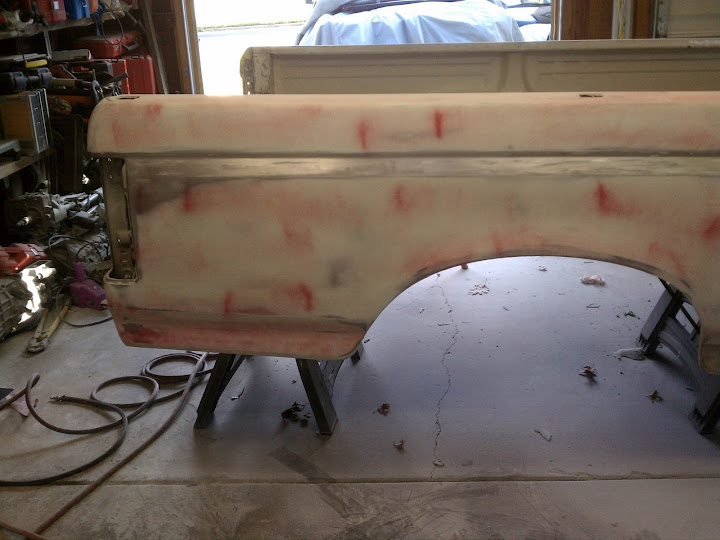

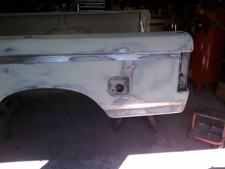

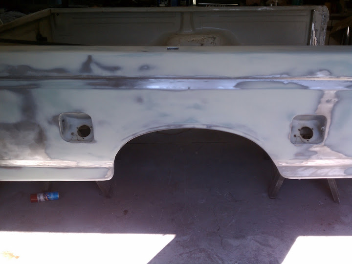

Drivers side glazed and sanded with 220, waiting for the other side to get done for primer.
Its straight now! haha
Other side, with the dent pulled and first coat of mud.
Here are the two fenders before I beat them out, the SD card was full so i didnt take any afters..
Noticed I had a few pictures in succession so I made a gif.

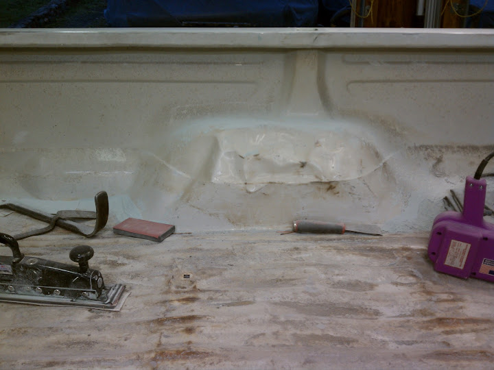

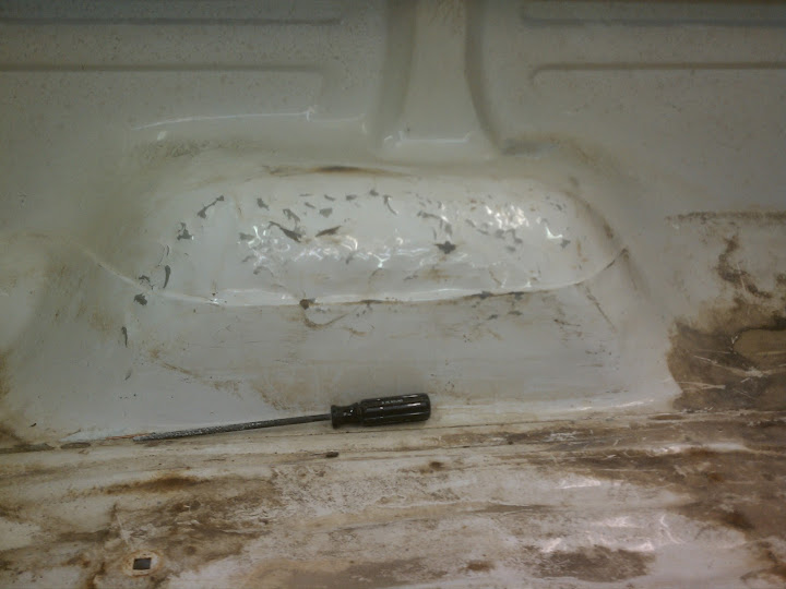

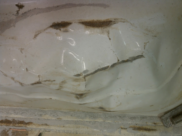

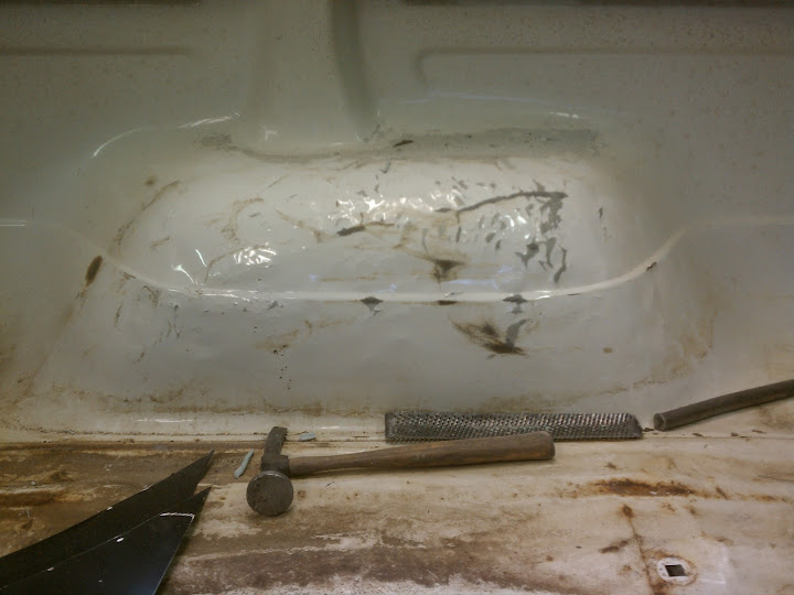

Didn't have much time this week. Heres the wheel wells beat back out. They will get coated with bedliner for rust prevention and the plastic bedliner is going back in, never to be seen again.

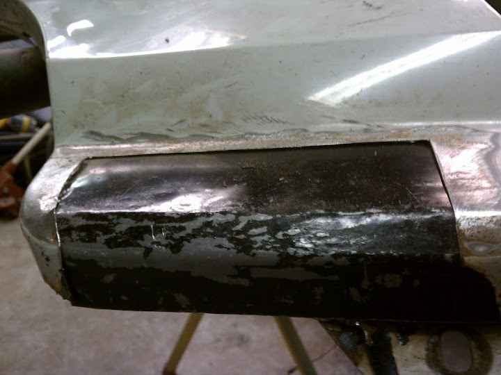

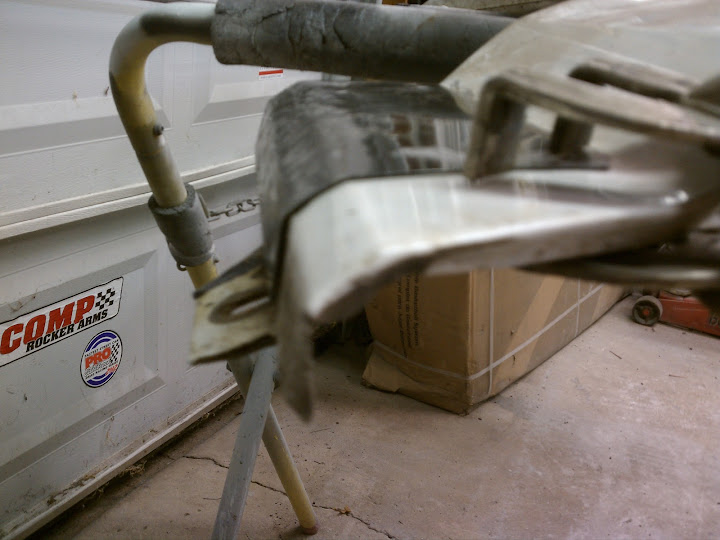

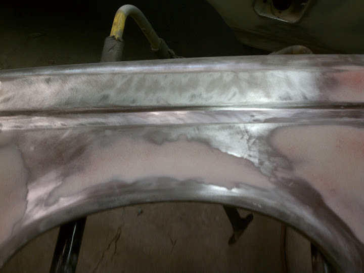

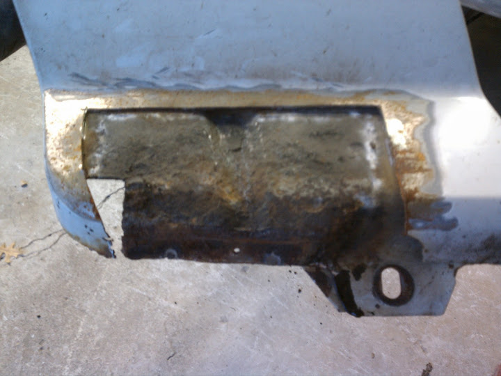

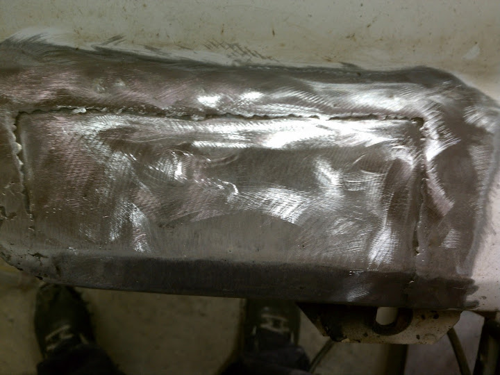

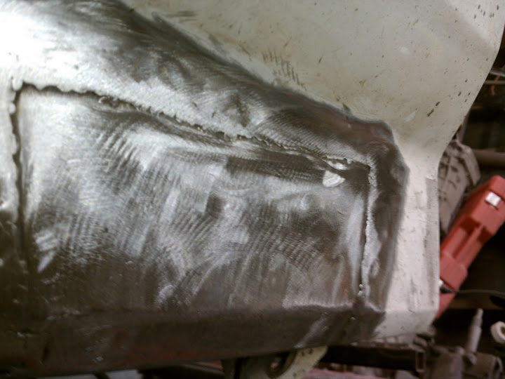

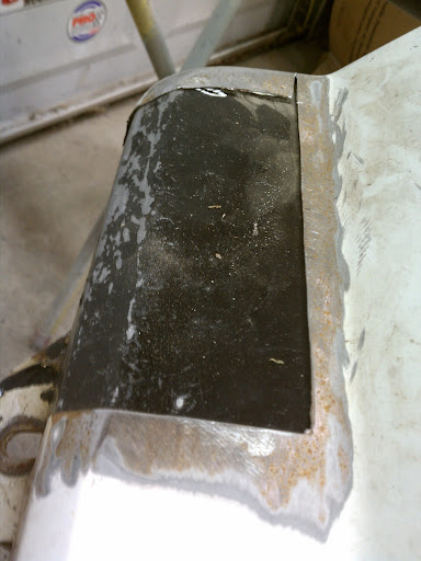

Had some time last night to play around with the fender.
Rot cut out

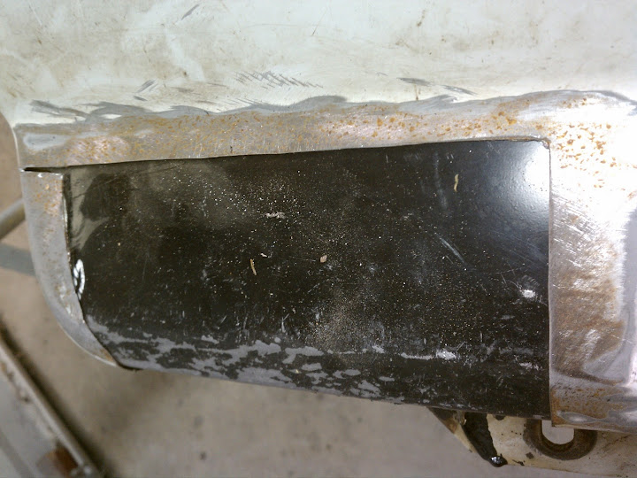

Started bending the patch panel.
Pretty close.
Test fit.
Good enough to weld.
Needs a little more grinding.
A little mud and you'll never know.

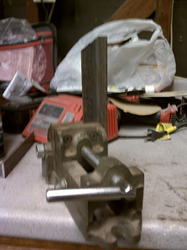

This is what i used to make the bends. Angle iron in a vise.

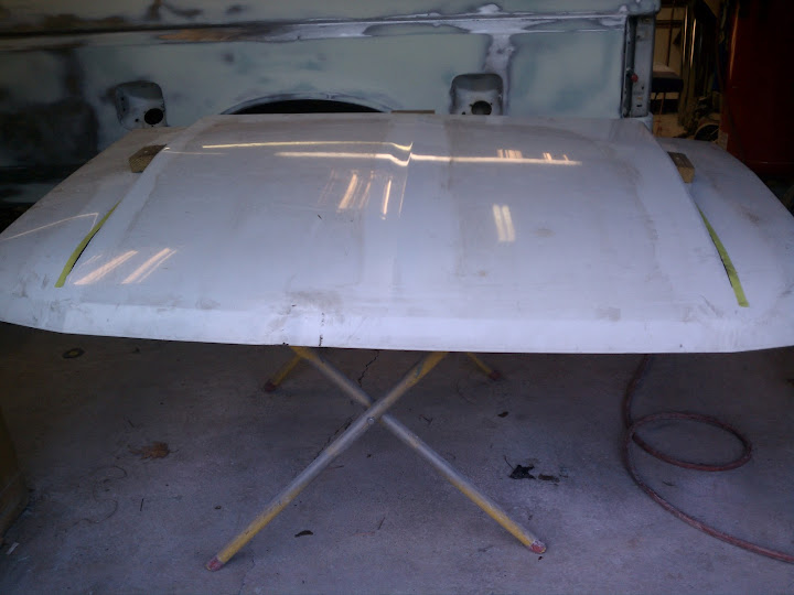

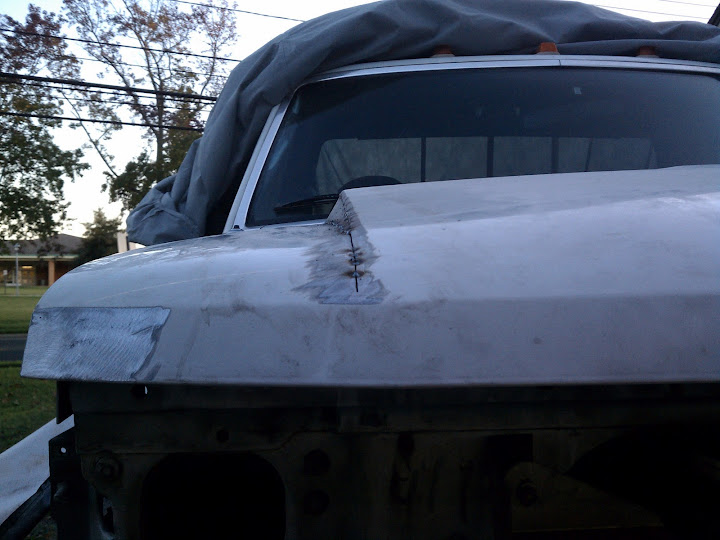

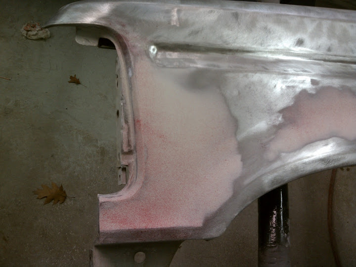

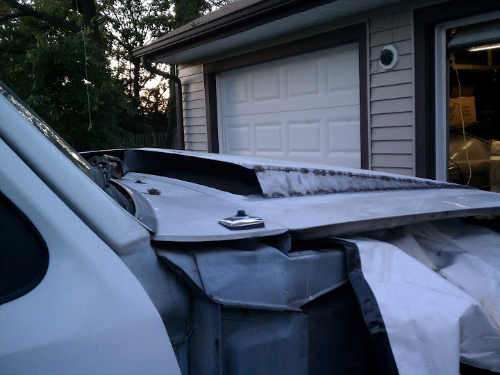

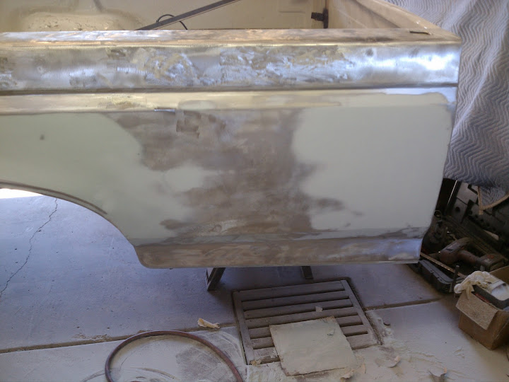

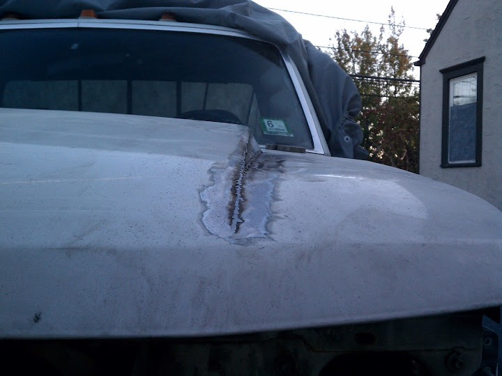

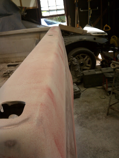

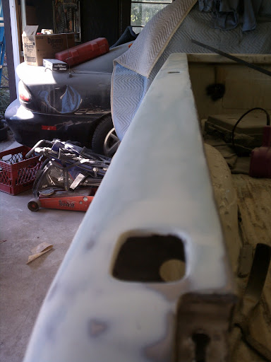

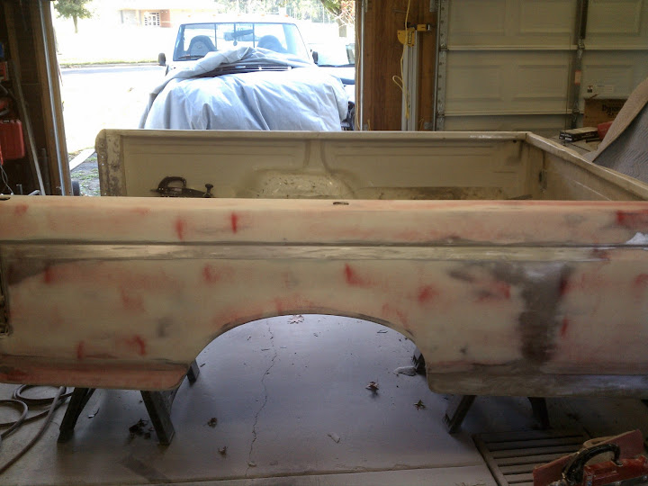

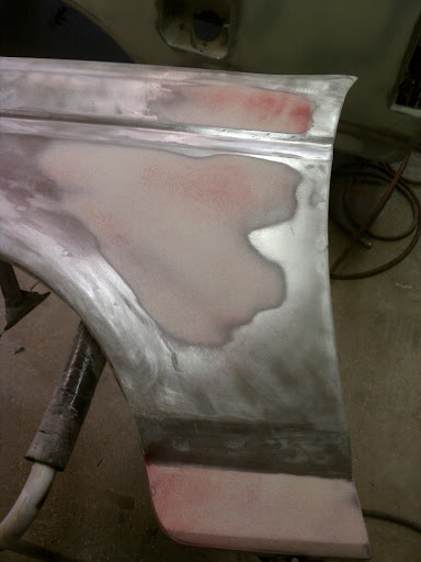

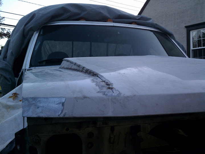

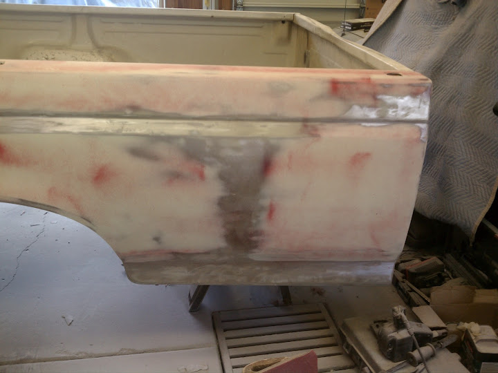

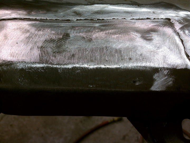

Drivers side fender is blocked, even tho the pictures show the guide coat still on. The passenger side bed is ready to be blocked. I started messing around with the hood. I have the hood cut apart and raised 3". I didn't take any pictures of it all tacked back together.
I had to weld, and rework the body line where the light bezel sit, what a pita.
Welded up the badge holes and the patch panel on the bottom came out good.
Glazed up, die coat on, waiting for 220.

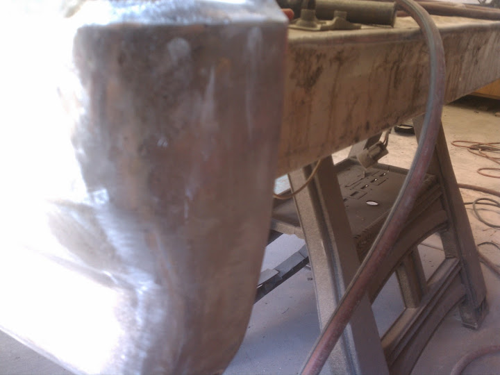

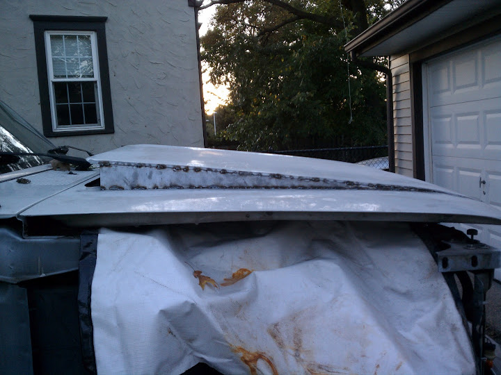

I have the sides welded in, I will get pictures later. I have a nice sunburn on my face from all the tack welding.

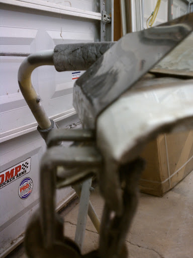

This is the first go around, I have since cut it out and layed it on an angle.

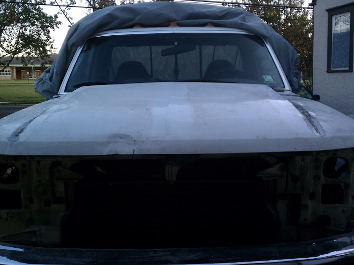

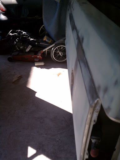

Shooting from the hip running.
Decided to do a test fit before i finish welding it.
Yay Nay?
