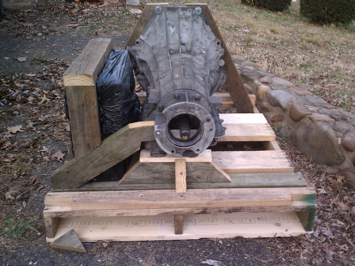

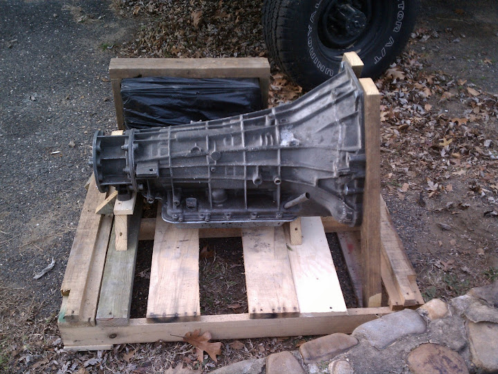

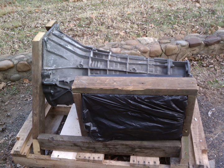

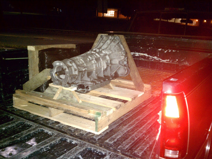

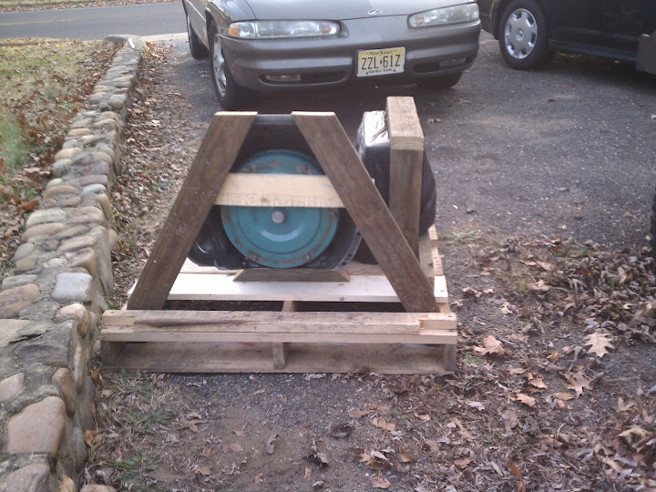

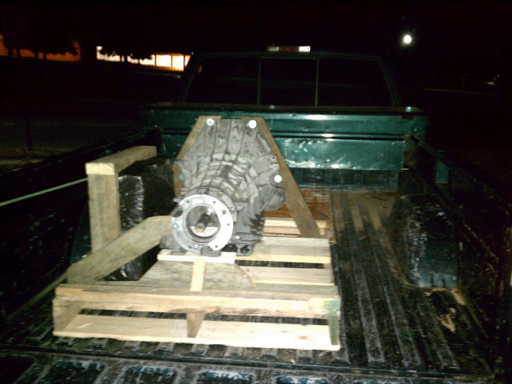

Since the month of overtime is over. I had some time to crate the trans and ship it. The crate is pretty sturdy, I had it standing on its side to get it in the truck. I used some old wood from my fence, and a pallet I got out of a dumpster.
I put it in the truck myself. Stood it up on the bottom, leaned the top on the tailgate and picked it up. Wasn't was heavy as trying to pick up the trans just by itself.
Now I need to find a gas heater for the garage that will allow me to finish up the body work.

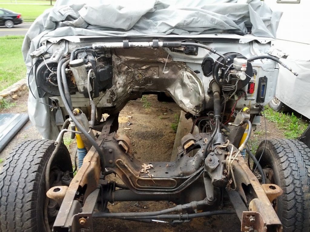

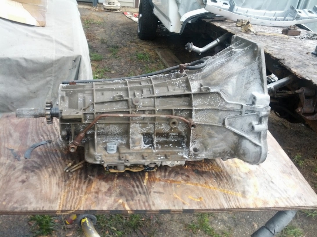

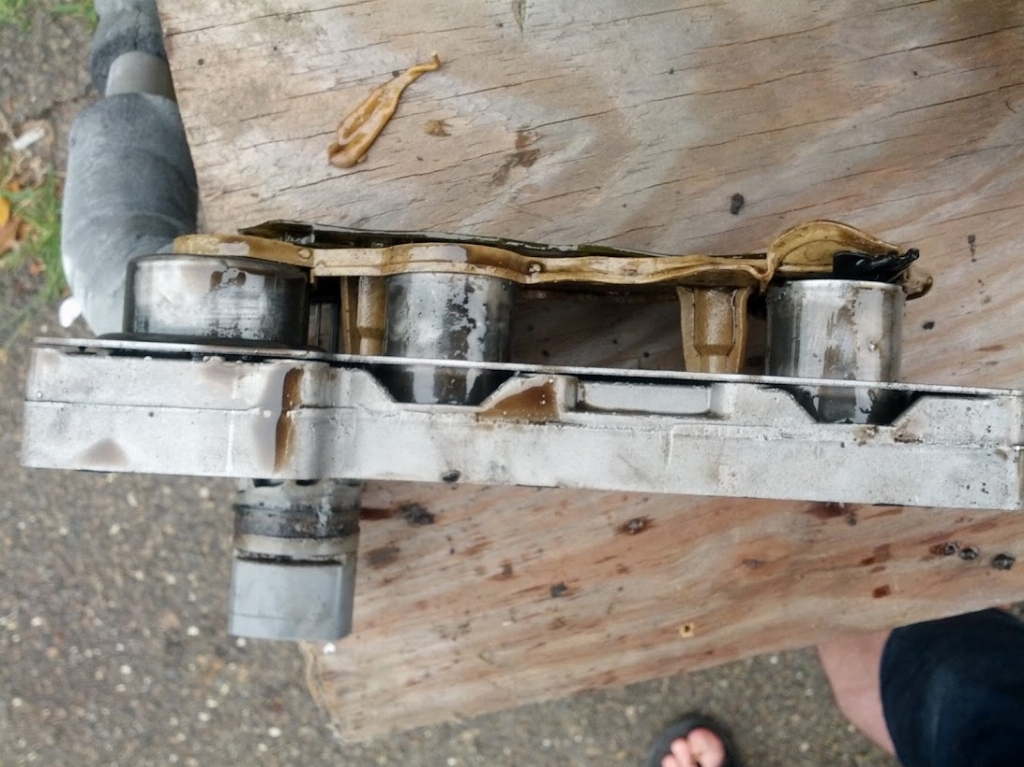

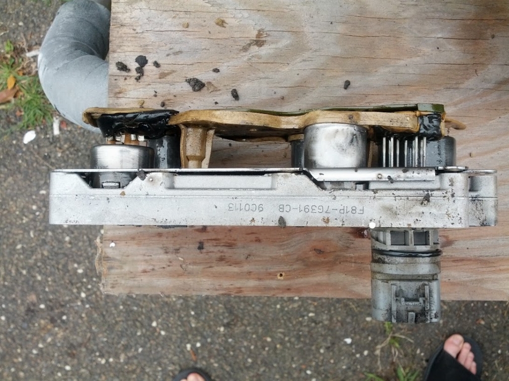

Well its been a while. The above transmission was no good for a core. I did find another core but the core condition is questionable.
I finally got time yesterday to tear the truck down a bit more.

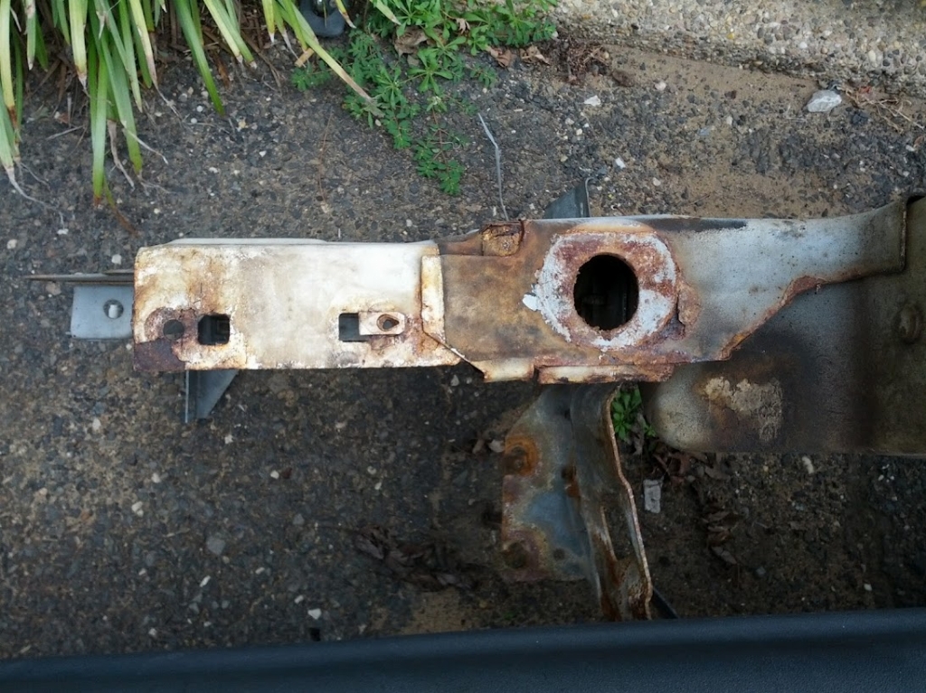

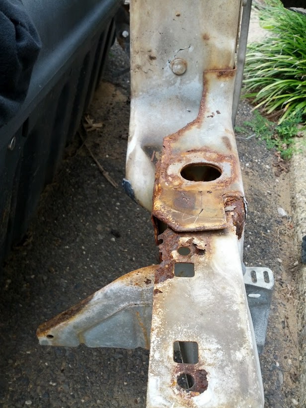

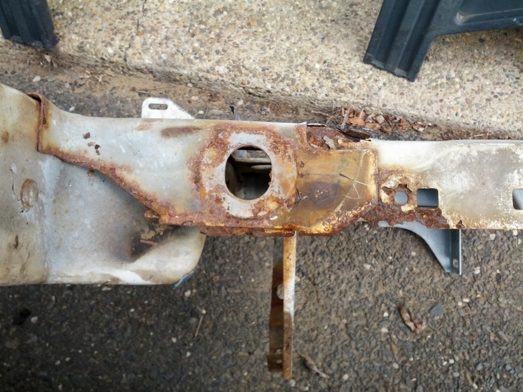

Rad support appears to be salvageable.
Drivers side was a little worse.
Whole lot of room now.

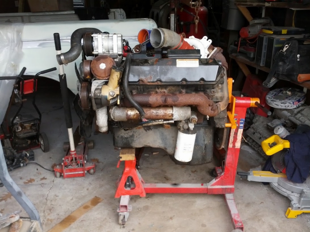

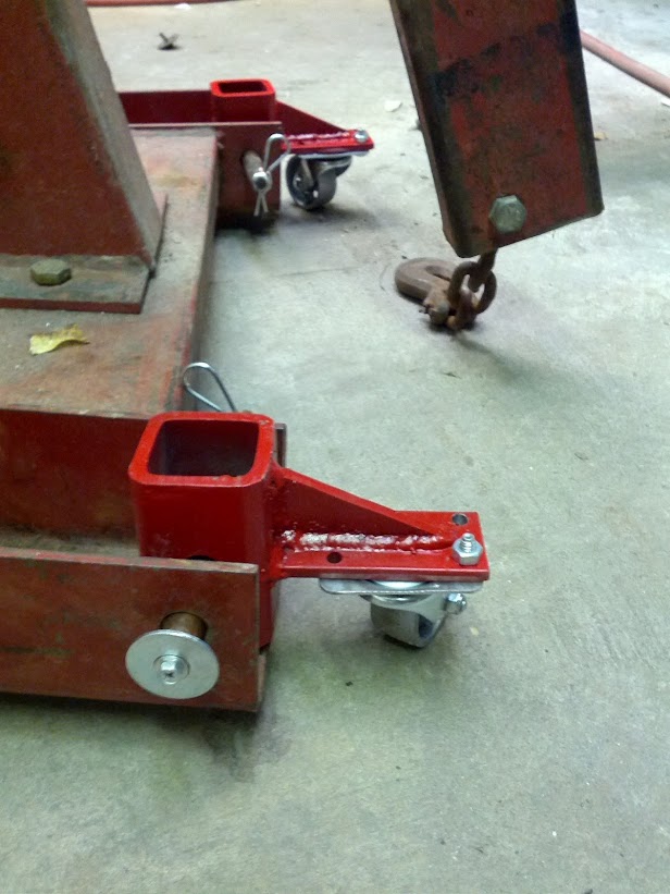

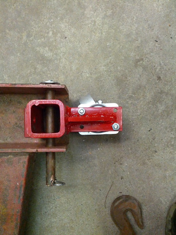

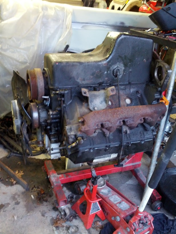

It got real old, real quick, when I had to dig the cherry picker out of my father in laws garage to use. Then dragging it around mine sucked. So I spent half of the day today making these castors. They use the leg holes when the legs are up. It so much easier putting the legs down and up because you can pivot the stand on 3 wheels. Moving the stand around the garage while it is "stored" is soooooo much easier. They are a little crude. It was 100 degrees in the garage, so I had no patience. Total cost was $10. Only thing I didn't have was hitch pins and steel castors. Everything else was laying around the garage. Need to get 4 more 1/4 x 20 bolts.
There it is, upside down. Waiting for me to pull the pan, and fix the dipstick seal. Would like to upgrade the LPOP while I am there. Injectors are out as well. Debating powerwashing this pig. I'm making the wrench tomorrow for the clutch fan.
Notice the oil spot? I was draining the oil. I had the pan up on the cross member of the stand. Don't you know I turned around to get something and it fell over. Right onto my feet and I had flip flops on.
