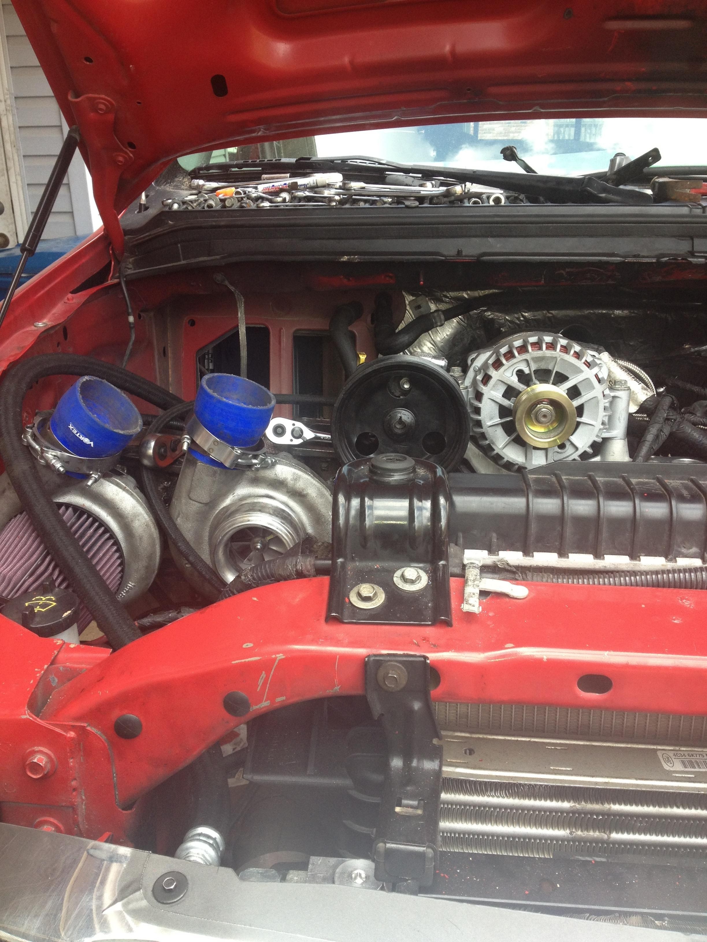

im not sure jesses kit can mount up to compounds thought can it? maybe he will chime in. Also been waiting for the Pump from adrenaline....
Yess it will fit I have it on my truck with my triple turbos.
