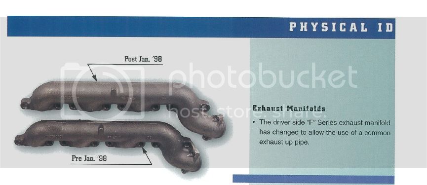

Pretty much look for the gap or not between casting of the bolt hole for manifold to head and bolt hole for manifold to up-pipe. Those with the gap are for the 99.5-03 turbo setup.

But both sides aren't tall enough right?
Jason said that he thought the exhaust manifolds only mattered on the 94 and 95 models.
Passenger side fit, drivers side does not.
Drivers side manifold is shorter on 94.5 to E99...
Change the manifold and the issue is gone.

Do what Joe says. If using stock uppies you can make it work. With bellowed, you gotta swap the exhaust manifold.
The pic makes it look like the OBS manifold is shorter in length.

the bolt holes are the same on both manifolds or you wouldnt be able to swap them..the only differences is the end of the maifold..It is shorter and the end has a different angle on it,,, I did not have to change my manifolds on the 1/98 built motor but I can see the different on my 95 I'm about to drop in...

Update one the install. So I ordered new manifolds and when I received them they were the same as what I already had on the truck:banghead:
So the conclusion I came to is that the Dorman manifolds are a little short. I pulled them down tight to the manifolds with the bolts. They stretched about 1/2 inch total to reach the passenger side after the drivers was pulled tight.
