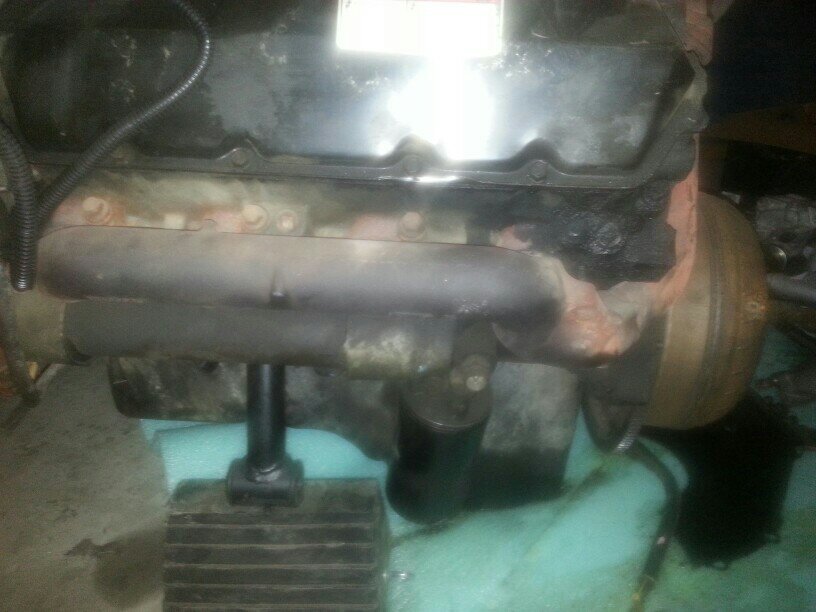

This is the OBS one.

I feel like your avatar is dead nuts on for this thread Eric......everyone just looking at each other, not sure what the answer is LOL
LoL, from my knowledge of the 7.3 ( which is little ) the manifolds changed in 1997 to the Super Duty style starting with the 450 and 550 trucks and then was standard in 1998 production runs of the E99 250 / 350 trucks. I just happened to have a 1997 OBS one on the floor in the shop right now.
