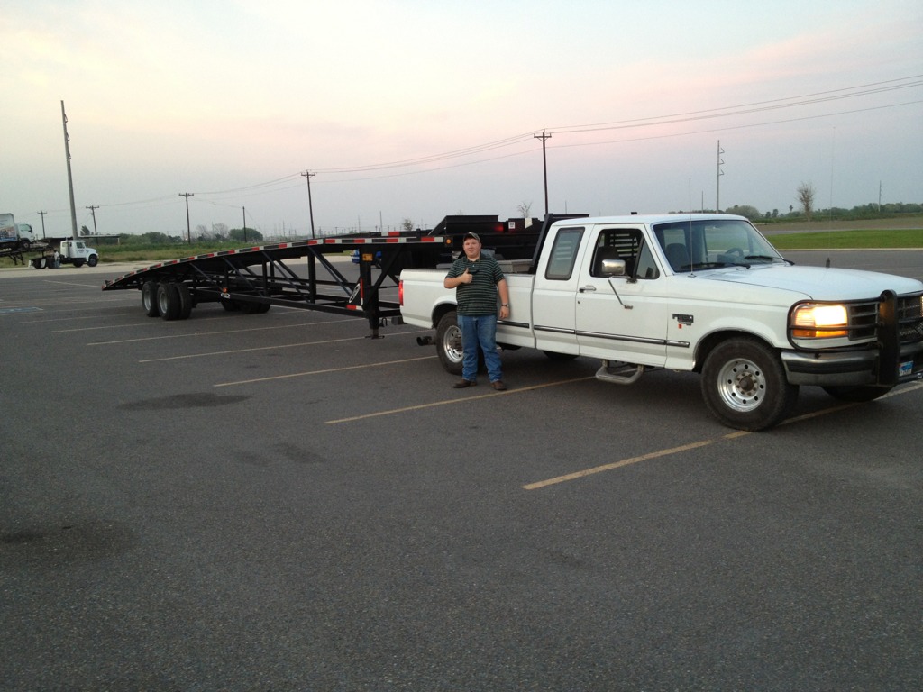

I want a pic of that trailer. Who made it?
Not sure who built it. It was originally dual duals and they put the 3rd axle under it. It was a 3 car trailer with extension ramps on it. It was a rolling ticket for sure. We pulled the tires off the 3rd axle before we pulled it like that. Got lucky I guess. And sorry I don't have any pics of it. Very similar to this one just with a third axle under it. ImageUploadedByTapatalk1338082014.327782.jpg

Thanks. That would be a heck of a trailer with 3 axles. I was looking at a 40' triple dual but it only gains me about 3500lbs of payload over my tandem dual. Not enough for the money right now.
