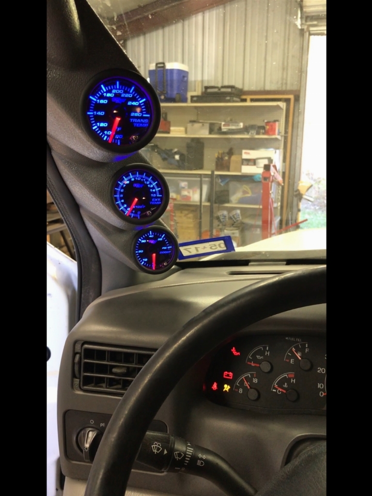

Yeah that does look pretty sweet but too much eye candy for me so I bought the three pod at riff raff and installed it near and front of the driver knee.

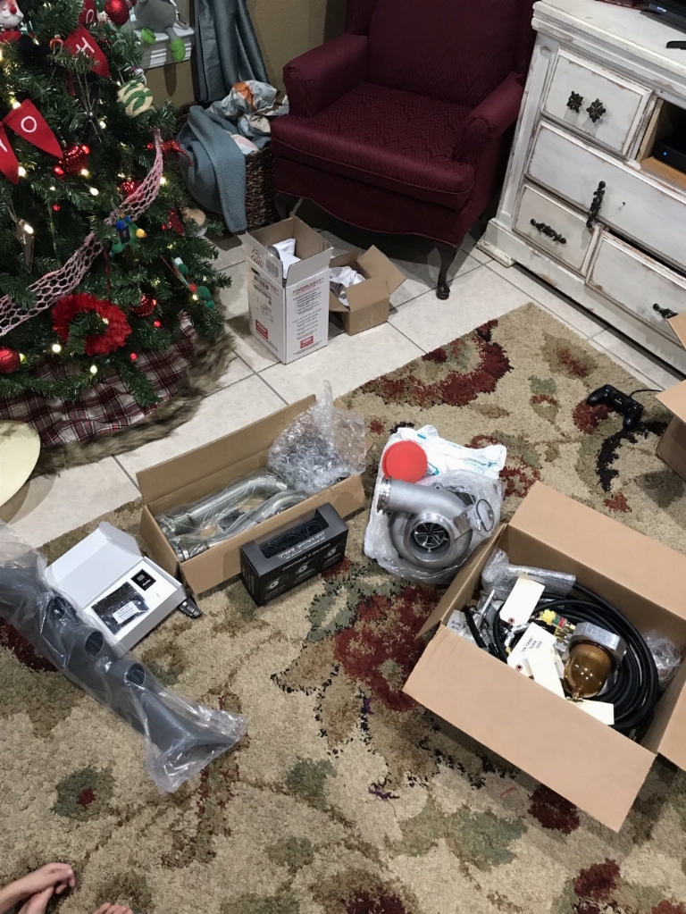

Santa stopped by early
I promise I'm not on DieselSite's payroll, but with their effort to go the extra mile for the customer to help ease install, and with an instruction book that's more detailed and loaded with pics than any instructions I've ever seen. How can I not brag on them, I love those guys.
Haha bout to say I saw some dieselsite items! Those guys are top notch only an hr from me.

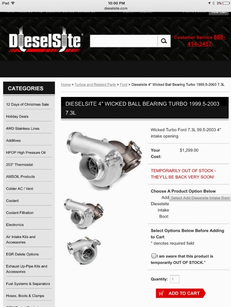

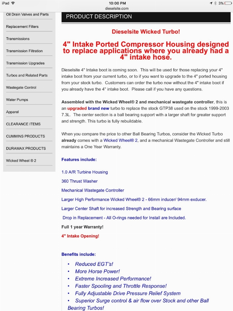

And is that a kcturbo? I got that and the 1.0 hotside and egts are none existent.
twisthappyr6
39
Buna, TX
Nope, that is DieselSite's 4" ball bearing. Already loaded with their WW2 and mechanical waste gate

those gauges are crap tbh, would've been better to get a CTS2 on black friday. Love the suspension work tho
twisthappyr6
39
Buna, TX
Thanks, I’ll see how these turn out and may replace one by one with auto meters or something of more quality.

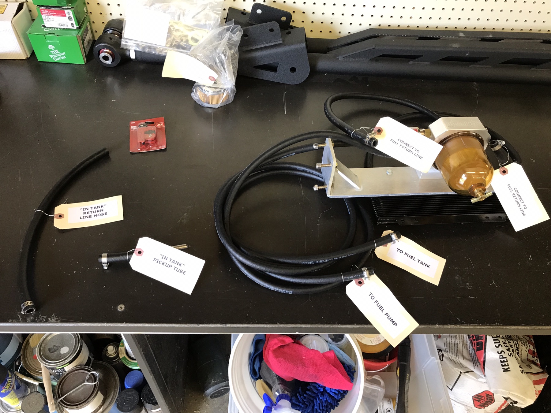

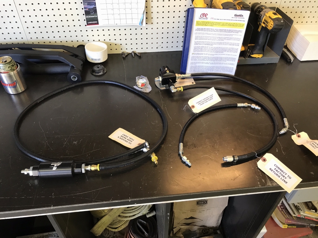

Finally got everything back together over the weekend. I’ve probably put a couple hundred miles on it and couldn’t be happier, like driving a different truck.
The CPR fuel system went on without any issues, but I will say installing the turbo was a pain. I couldn’t get the turbo to line up with the collector to save my life. I spent 6 hours trying different things. Turns out I just needed another set of hands. I had my dad come over the next morning and we had it together and torqued in literally 10 min. So if your doing a turbo install for the first time, do yourself a favor and get a buddy to come give you a hand with the alignment portion.

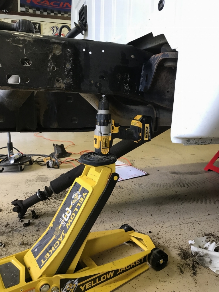

10-4 . Wanted two but they only had the display so I took it and ran with it.
Btw - best jack iver ever purchased besides my air jack (sob lifts the F350 over 36” in 30 sec haha)!
Keep up the good work - looks good so far brother!
little derail, what jack do you have that goes up 36" in 30 seconds?

It’s them air bumper jacks that uses compressed air
Love it!
