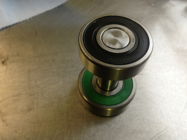

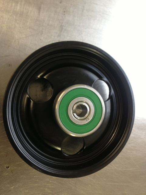

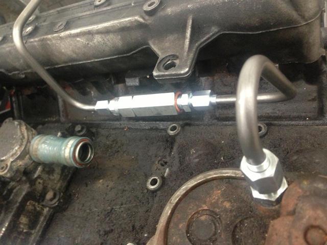

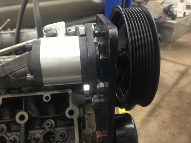

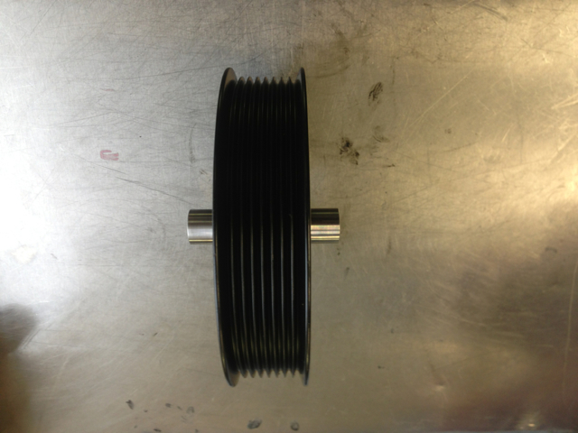

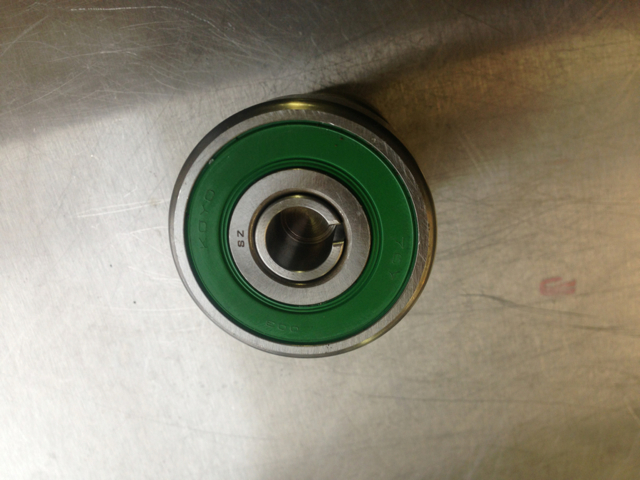

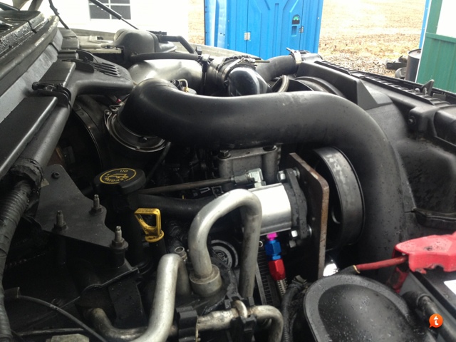

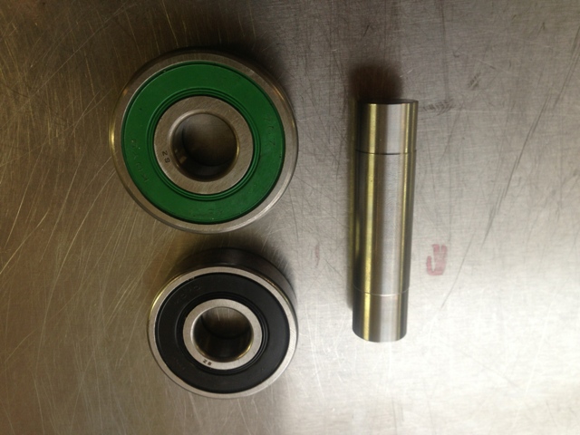

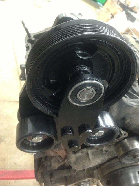

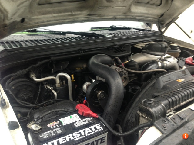

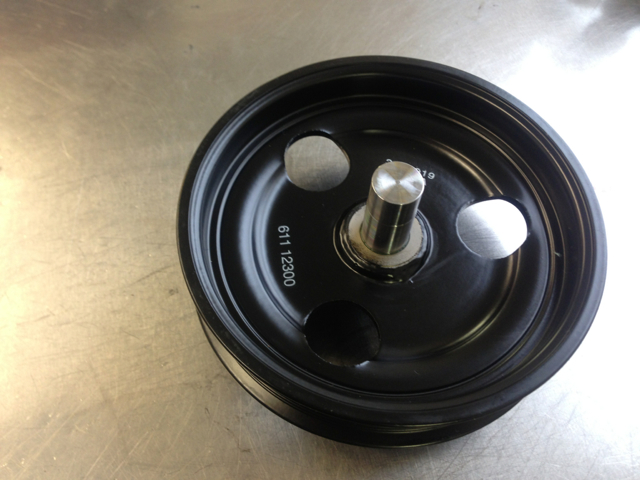

Not all that fancy but sure works nice
ImageUploadedByTapatalk1395255635.519181.jpgImageUploadedByTapatalk1395255652.285052.jpgImageUploadedByTapatalk1395255668.034885.jpgImageUploadedByTapatalk1395255701.501454.jpgImageUploadedByTapatalk1395255733.567988.jpgImageUploadedByTapatalk1395255750.517957.jpg

Shaft is a hardened to rockwell 40. Pump floats and can be changed in 5 min.
Some more changes to be made. We won't offer a kit. Just a bracket. Pump can be bolted on in minutes.

Jesse,
Did you ever try to pull the oil from the distribution block on the cooler cover?
I never have. Never liked the idea of sucking oil off the low pressure. Would hate to loose oil to bottom end bearings at wot.

I hear ya. Low flow once changes the world. I was hoping for a been there, done that, and, i) OK but not sure, or ii) don't want to do that again.
There is a spot for an oil supply port for air compressor (optional). It just had me thinking if there was enough oil to use in a larger application.
